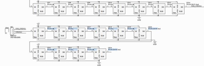

Also looked into the schematics, but can’t get it figured out…
So the 1st string is properly working.

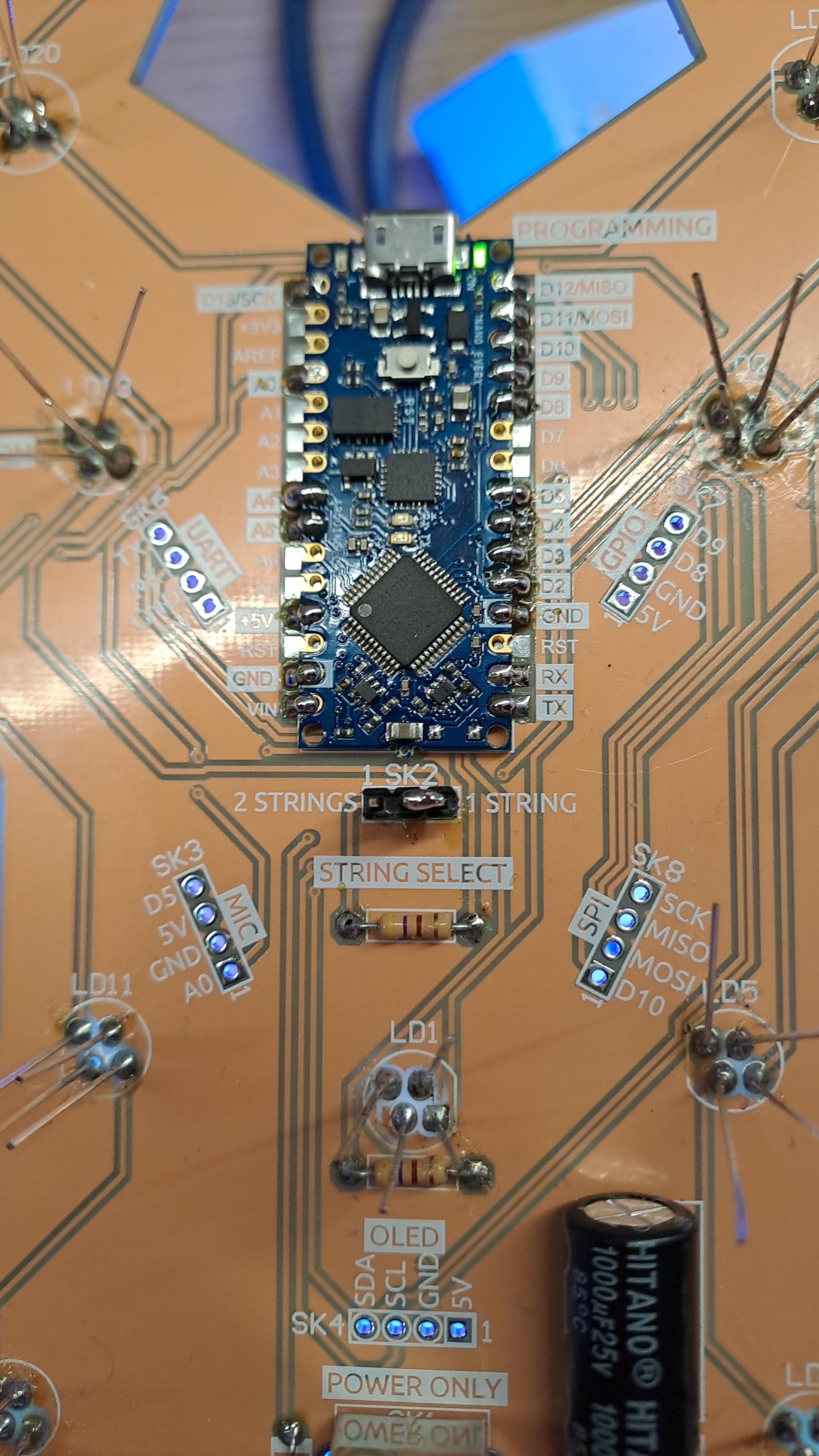

But then after the last LED from the first string, the schematics come at the pin header.
I have 3 pins:
RHS = end of string 1
MID = beginning of string 2
LHS = Rear end of the resistor that is coming from the arduino
So I put the jumper from RHS to MID pin (the jumper does not fit at all, so now even just soldered it toghether).
I have the 1st LED from the 2nd string working properly.
The 2nd LED is lighting RED (while others are white), so I believe that the current it’s receiving is too low.
From 3th LED onwards, the 2nd string isn’t lighting anymore…
What am I doing wrong?
