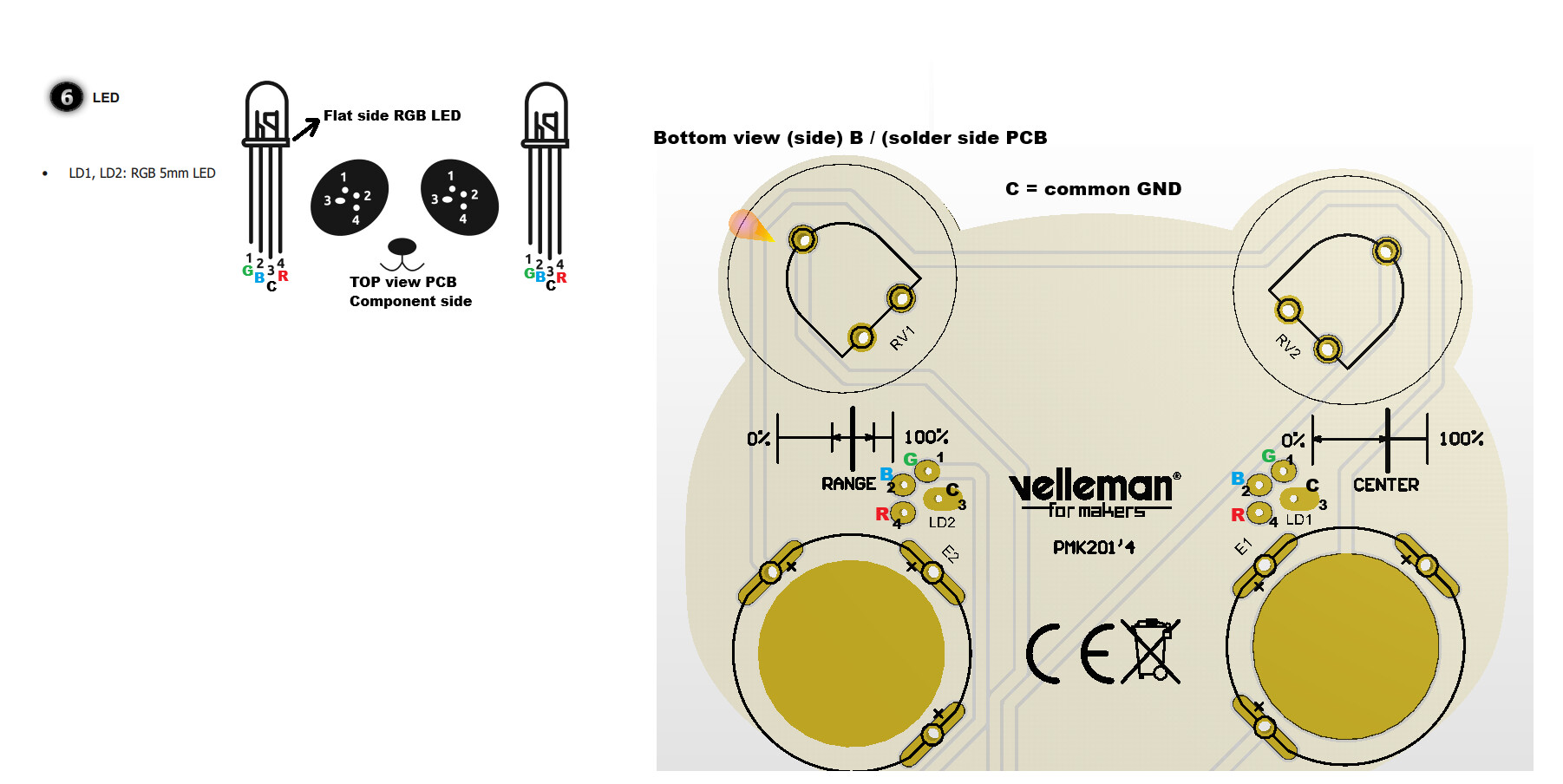

I could really use some advice on how bend the legs of the LEDs for this kit. It is confusing at best as to how to arrange them without causing a short circuit. - Phoebe
Hello @Phoebe
Zie hieronder op foto de pin aanduiding van de RGB LED met pin nrs aangeduid op PCB
Hoop dat dit verduidelijkt hoe de led te monteren.
