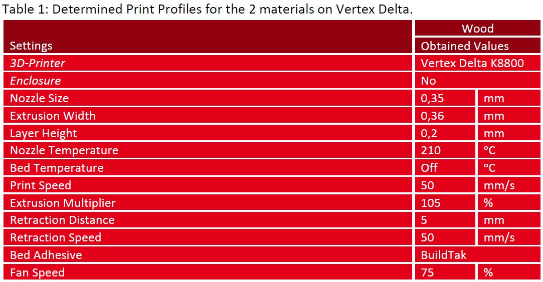

These are the settings in cura for wood fillament on Vertex Delta. See table below.
By this test the standard nozzle 0.35mm was used. but we advise to use a nozzle > or = 0.4mm to avoid clogged nozzle.

On that chart you have nozzle size 0.35mm but the nozzle is 0.4mm
Why is that?
Hi @Wrong_Way,
All our filaments (yes, all of them!) are tested on the Vertex Delta, which has a 0.35 nozzle.

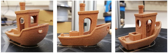

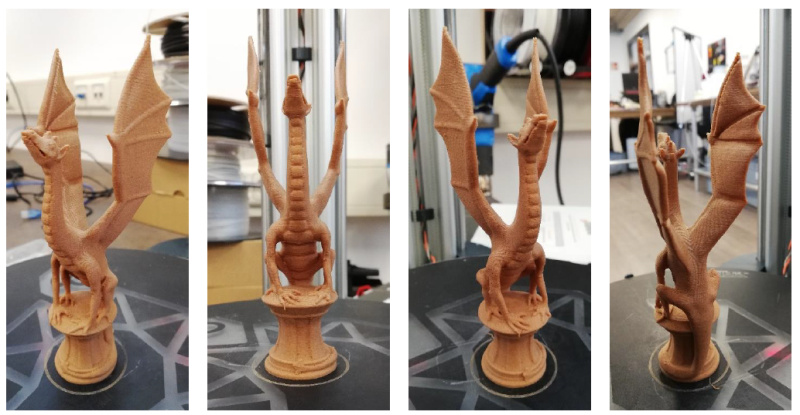

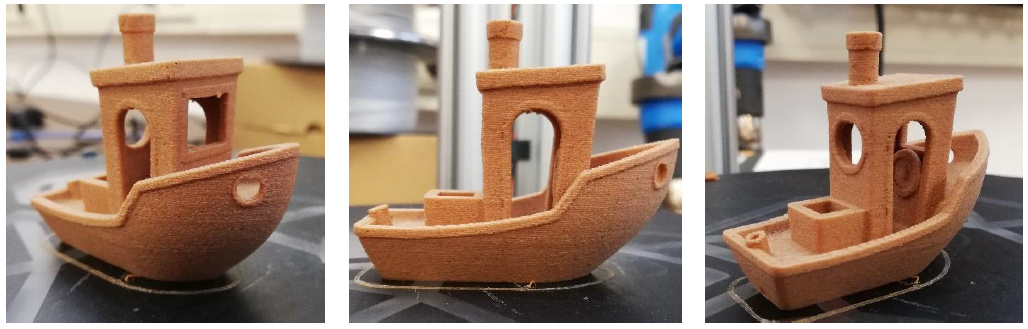

The results of the wood filament were great:
However, even with the settings above, some users reported that the filament could get stuck after printing for a while. We therefore recommend using a 0.4 mm nozzle or even a 0.5 mm nozzle.
