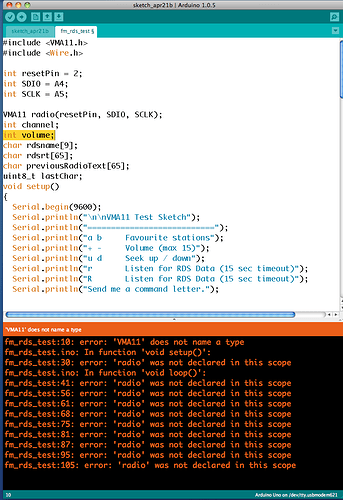

I does not consist of this message of error?
I transmitted the TEST bookshop
fm_rds_test:10: error: ‘VMA11’ does not name a type
fm_rds_test.ino: In function ‘void setup()’:
fm_rds_test:30: error: ‘radio’ was not declared in this scope
fm_rds_test.ino: In function ‘void loop()’:
fm_rds_test:41: error: ‘radio’ was not declared in this scope
fm_rds_test:56: error: ‘radio’ was not declared in this scope
fm_rds_test:61: error: ‘radio’ was not declared in this scope
fm_rds_test:68: error: ‘radio’ was not declared in this scope
fm_rds_test:75: error: ‘radio’ was not declared in this scope
fm_rds_test:81: error: ‘radio’ was not declared in this scope
fm_rds_test:87: error: ‘radio’ was not declared in this scope
fm_rds_test:95: error: ‘radio’ was not declared in this scope
fm_rds_test:105: error: ‘radio’ was not declared in this scope
Hi
Did you installed the library correctly?

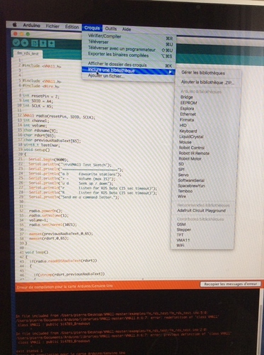

Merci pour votre réponse, la" library" est bien installéé
"avrdude: ser_open(): can’t open device “/dev/cu.usbmodem411”: No such file or directory
Problème de téléversement vers la carte. Voir http://www.arduino.cc/en/Guide/Troubleshooting#upload pour suggestions."

C’était bien le “port série” qui n’était pas le bon… le téléversement se fait correctement .
Merci beaucoup…
