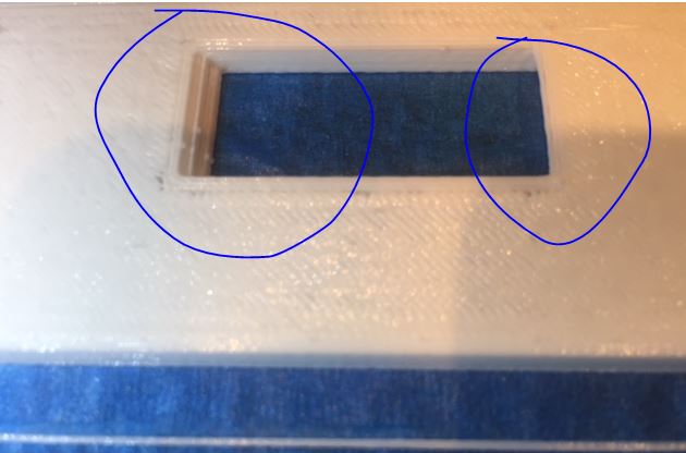

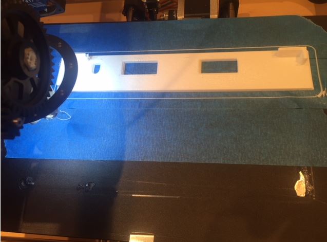

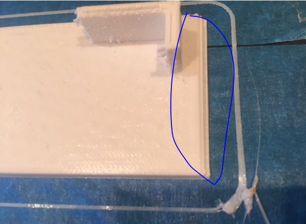

Normally, I have no problems with my k8200 printer. However, for some days, I have problems with the Y Ass, he is drifting constantly, once more than the other time. Now I’ve been trying to figure out what the problem is for 3 days. Have checked the engine voltage, this is exactly 55.5 volts, I also gave him more voltage and less but it does not matter, now I set him back at 0.55 volts, bed run smoothly, I can move the finger very smoothly , use oil to make even better running. The K8200 printer is expanded with 400 x 200 bed, which worked fine until recently. The belt is not too tight and not too loose, feels good. yet he only drives the Y ass. What’s up? Can I still get some settings to make him walk better? Als in the firmware and software i made changes so the printer is printer with slower speed in hope printing better but it doesn’t help, Z ass and x ass go fine. I use repieter software version V0.95f and slicr version V1.0.0rc3, use fast windows 7 laptop with plenty of memory and proccesor. Someone still tips, I’m getting tired of trying after 3 days and trying trying… please help.

I have recently a bed with 200 x 400, and when print the long site (400mm) he don’t liking that.
Print now for 3e times and looks great.
For people has a 20 x40 bed, please cooling the controlboard!!!
