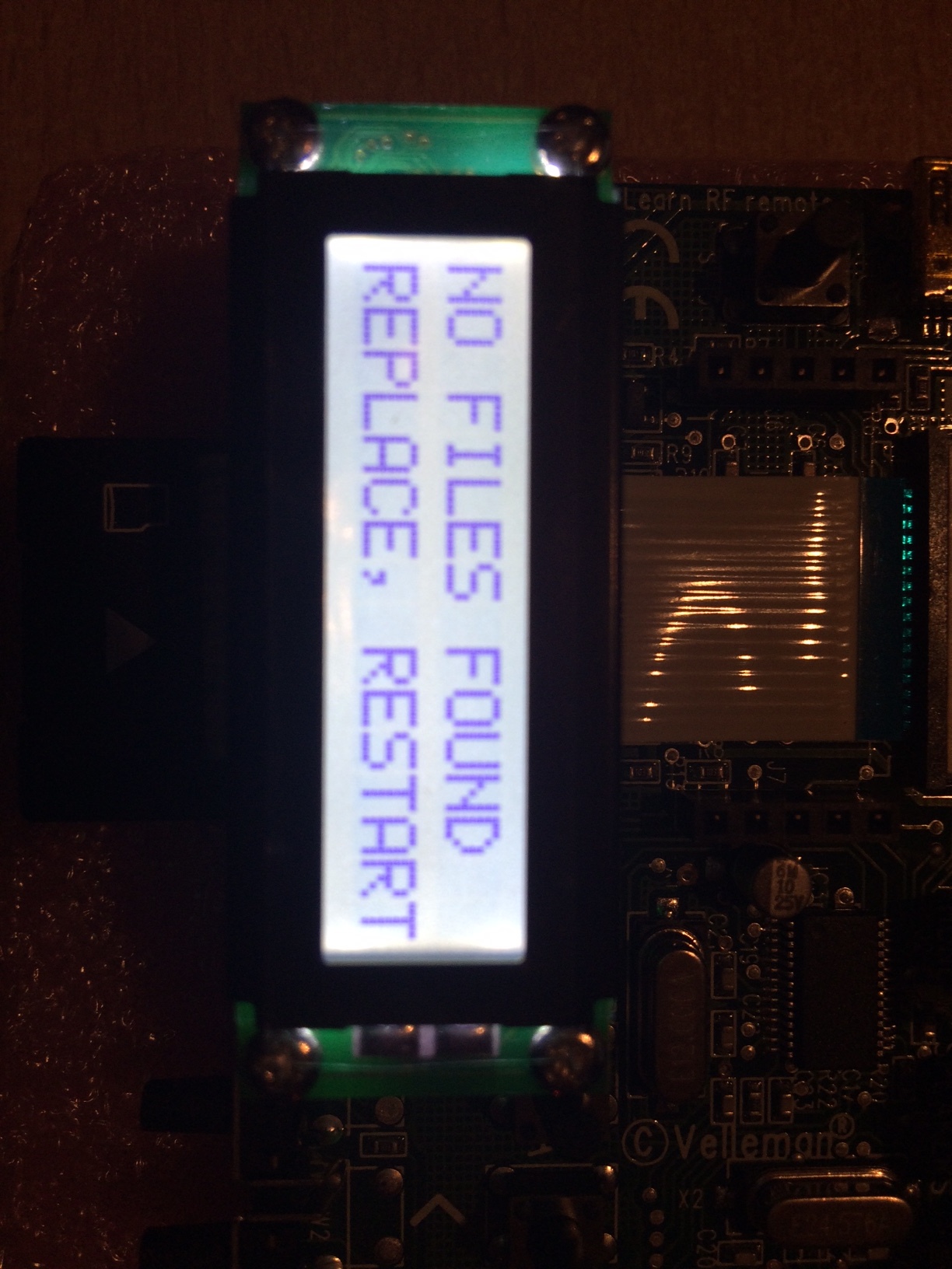

Hello,
After receiving a VM8095 module that did not recognize files on SD card, I received a new module. This also ran smoothly in the first two tests. Before the final installation in the case, I have now again made a test and again the device does not recognize files. I have tried an 8GB micro card in the adapter and a 128 MB card. All the MP3 files I have processed with the ID3 Remover, the cards were formatted using the SD Card Formatter of the SD Association. When working with the module I have always worn an ESD bracelet. Damage caused by static electricity can be excluded. For power supply I use a 12V DC adapter with 1.5A.
What can i do?
Do I have to worry about the second module being broken?

I removed the micro card with holder and i tried a regular SD card without success.
it looks like the SD card reader is a general problem with the VM8095.
Let’s see what the support team says.
If there is no solution I have to return the module and look for another technical solution for my mp3 player, for example Raspberry Pi.

I restored the orginal factory setting without success.
wrong file attribute can not be the reason, because the same files run smoothly in the first tests
This is very strange problem indeed.
And it’s also very difficult to solve remotely.
