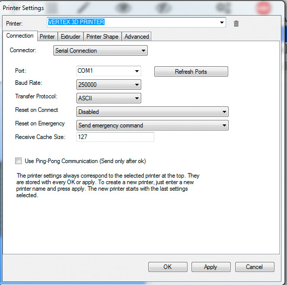

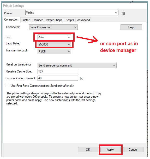

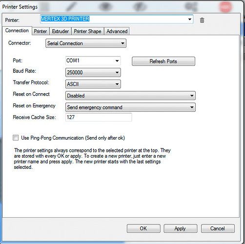

Must I sometimes have to do at the COM port settings? Are on both sides in my case at COM5 speed at 230400. Other settings?
Unzip this file and install it with forced administrator rights.
To do so, give a right mouse click onto the setup file and choose in menu: **Run as administrator.
Then follow the installation instructions.
Attention! Make sure that the JPROG jumper is disconnected on controller board K8400, when connecting to USB, and make connection with Repetier Host!
