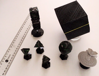

Above: Helping locals from the 3D print club explore geometry, in this case - a tesseract (printed with 35% infill).
Above: An array of geometries, to help inspire some at the 3D club or LGS to keep at it. The tetrahedrons were popular - it was great to hand a few out and encourage people to find ways to make their own (be that a pepakura/papercraft, etc).

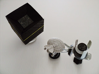

Above: A different perspective on a more complete tesseract, and a local who became ensnared in a Nexus - the k8200 is great for making ‘decoupage shapes’ - all the world is “legos”, if you have ‘lego vision’.

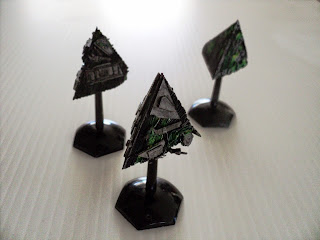

Above: Tetrahedral Polychora! These can be printed in a variety of infill, or high detail or basic detail. Measuring at 47mm (its near equilateral), it only took ~7mins to print low res, and 1,3hrs for ‘highres’ at a larger 68mm per edge - Perfect for public demonstrations. These have been ‘enhanced’ with paint, and some photoetch parts, and some twisttie packaging etc —
