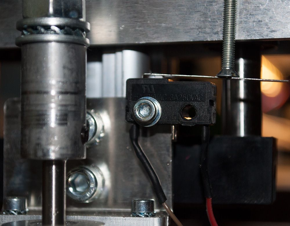

While printing no switch should be turned on at all, if so it looks like some hardware issue.
i had issues with the z-switch following the manual, i mounted the motor lower than written in the manual.
This is Z Home with Mirror (3mm)on the Heated bed.
