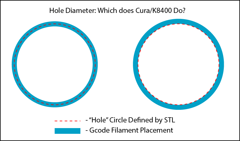

Imagine that a CNC with a mill make a round piece , then the mill will be on the outside of the piece. The path for the mill,bit will be small straigt segments, and imagine the machine was very coarse, so the path consisted of just 6 small pieces, that would look like a nut . Then to make it as well as possible ,there would be material left ,that made the piece a bit to big, there would be small parts left outside the ideal circle.
If you had to mill a hole, then the path for the mill would be inside the circle, and then there would also be a small amount left ,so that the hole would be a bit smaller than the ideal circle… If it was a agreement between the users that this was the way to do it, then you would always have a hole that is a bit smaller than you thought . ok But you can compensate for it.
If they had chosen another standard ,then there would ,I think ,have been other problems .
hope I have explained ,so its to understand …
alex
If the printer make an extruded filament of say 0,3 mm width .
If the program is made to follow the drawing lines, then the outside measures would be 0,3 mm bigger than the drawing. A hole would also be 0,3 mm smaller .
Maybe the program is made this way, and then it is not possible to make the part just as the drawing, and the constructor would have to enlarge the hole in his drawing.
The program could have taken into acount that the filament do have a width and compensate for hole diameter ,but then I think; there would have been other problems.

I have had similar problems in small parts fitting together. I always assumed it was because holes/sockets were handled like the left side of this diagram, meaning the actual hole would be smaller by 1 width of a printed line due to one-half of the line’s width extending into the circle boundary all the way around.
