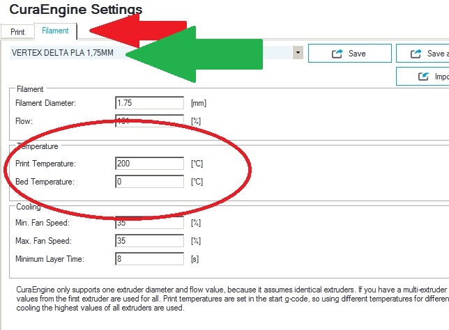

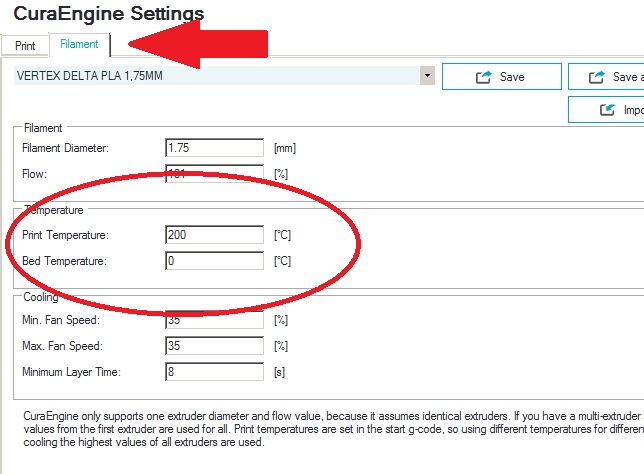

Hmm I cant seem to find the setting for that.
Is it the print temperature? or is that for the nozzle?
Its set to 250 atm but I cant seem to find the filament temperature levels
under CuraEngine settings->cura->filament->temperature (in repetier)
Should be in filament Print Temperature
Don’t forget to save the settings.
See below
3385
Also watch which profile you are saving it under
3385
so I was looking in the right tab and the right parameter, just that the naming was different and confused me.
