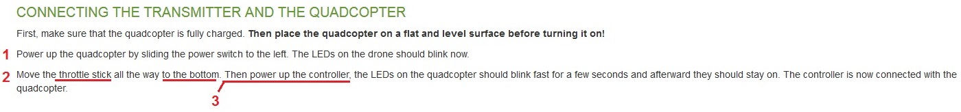

Here are the just synchronisation instructions between quadcopter and remote control (transmitter).
Do these steps in the correct order. Otherwise the synchronisation will not complete.
See the steps below:
If it not help to pair the transmitter with quadcopter, you can send it back to local shop for repair.
