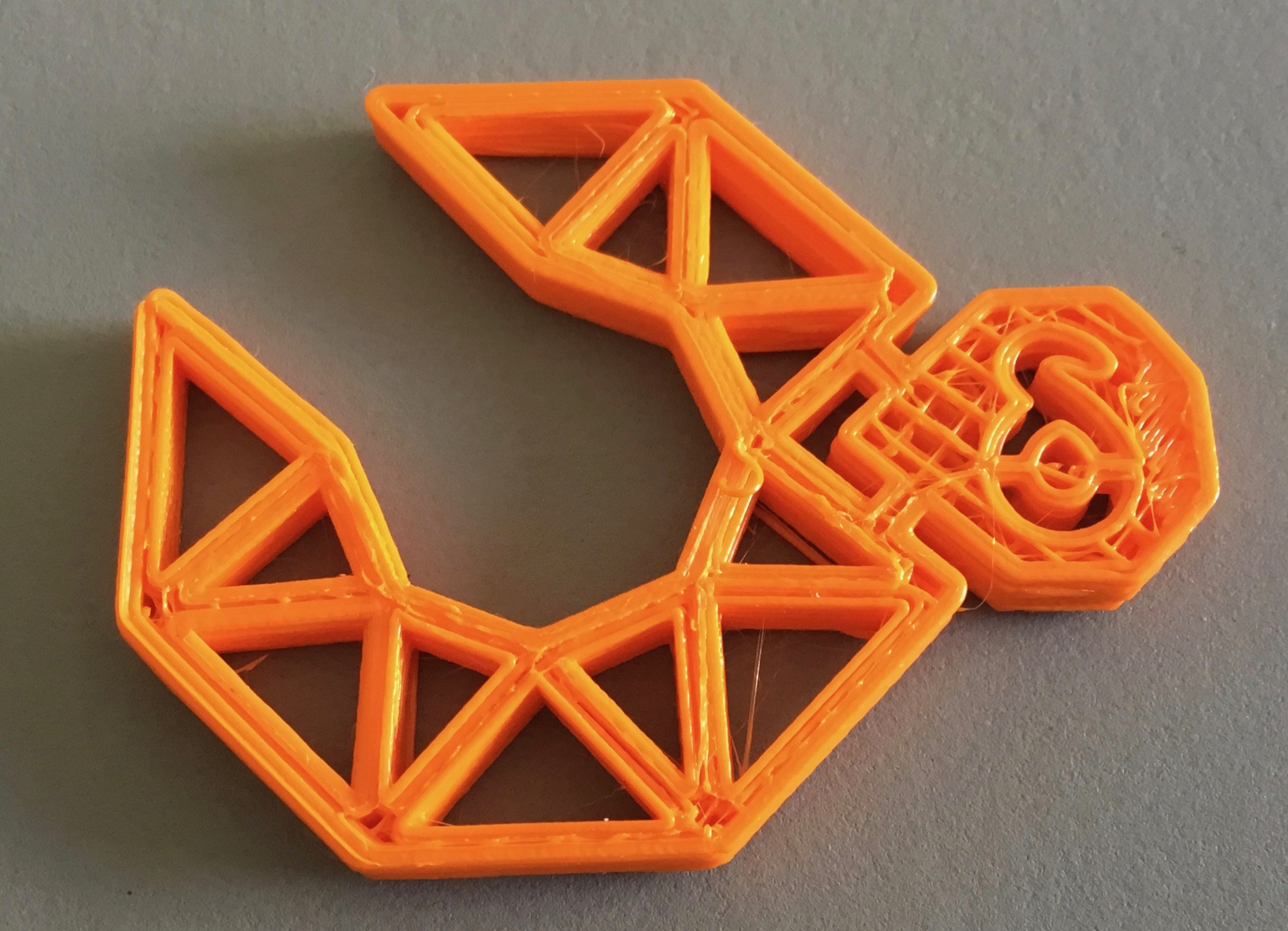

After mounting the delta printer I printed the test piece. I was not satisfied with the result so I try again.
During the second attempt, he stopped printing after 20 minutes. After repeated attempts, there is still no filament leaving the nozzle.

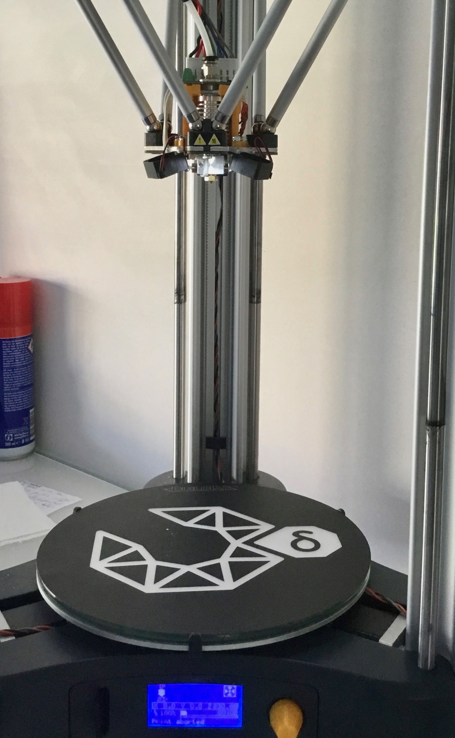

Can you post a picture of your build?
What do you mean stopped after 20 minutes?
VEL337
Printer stopped without any reason. I wanted to restart but no filament is leaving the nozzle.

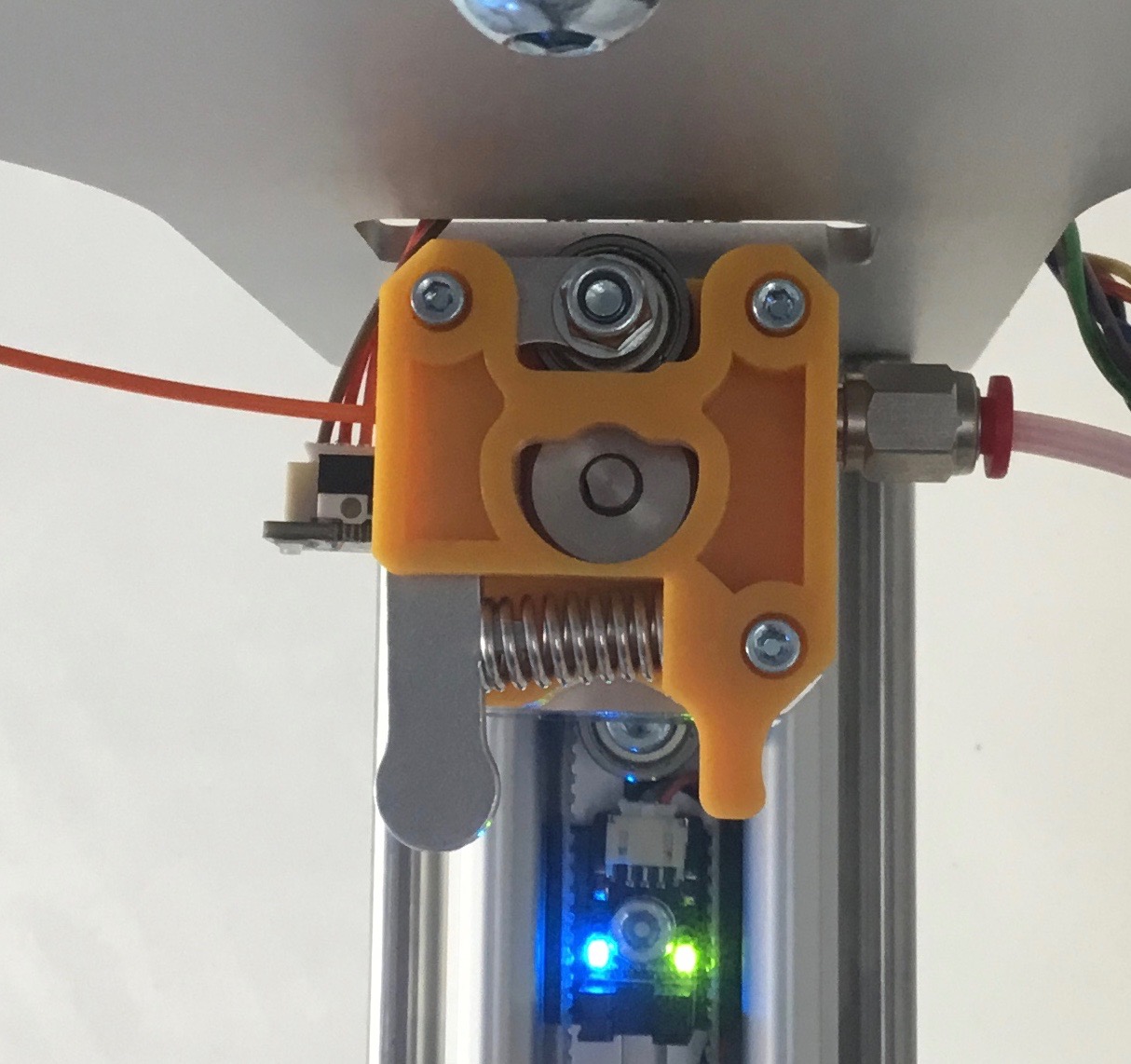

On the extruder there is one screw that goes through the lever.
You need to leave that one a little loose

Could you post a picture of the printer?
I have seen where some have mounted the print head wrong and did not put the proper twist on the cable.

The filament feeder doesn’t work like it should. The wheels are slipping on the filament.

Is the set screw for the filament pulley tight?
Can you unload and load the filament?
