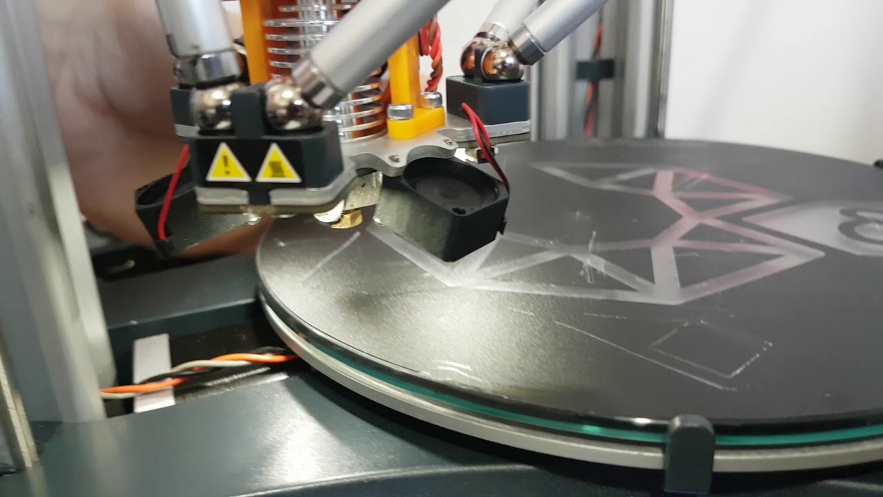

Printhead crashes on bed on second print
I’m having this weird issue where if I attempt to print a new model right after another one finishes, the print head comes crashing down on the bed with enough force to tear a gash in the buildtak and dislodge the support rods. It happens during the “Leveling bed” phase, on the first, lower left coordinate. But only on the second print, the first one calibrates and prints successfully. If I run a calibration between the prints it does not seem to happen, but I shouldn’t have to do this every print, right?
Any ideas what might be causing this?

I’ve uploaded a video to demo what happens when printing again after a successful first print
Video is exactly what happens to me too, same coordinate, same horrible sound (from both machine, and me :D)
