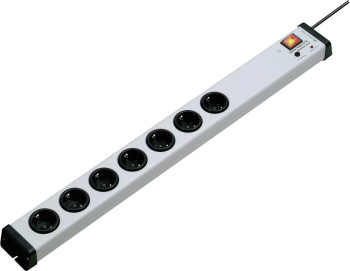

That is a really common problem.
TL Lights emit huge noise to the power line when starting.
Try a multi socket power strip with net filter
and connect anything printer related to it. Also the PC.
In most cases that will prevent stops.
