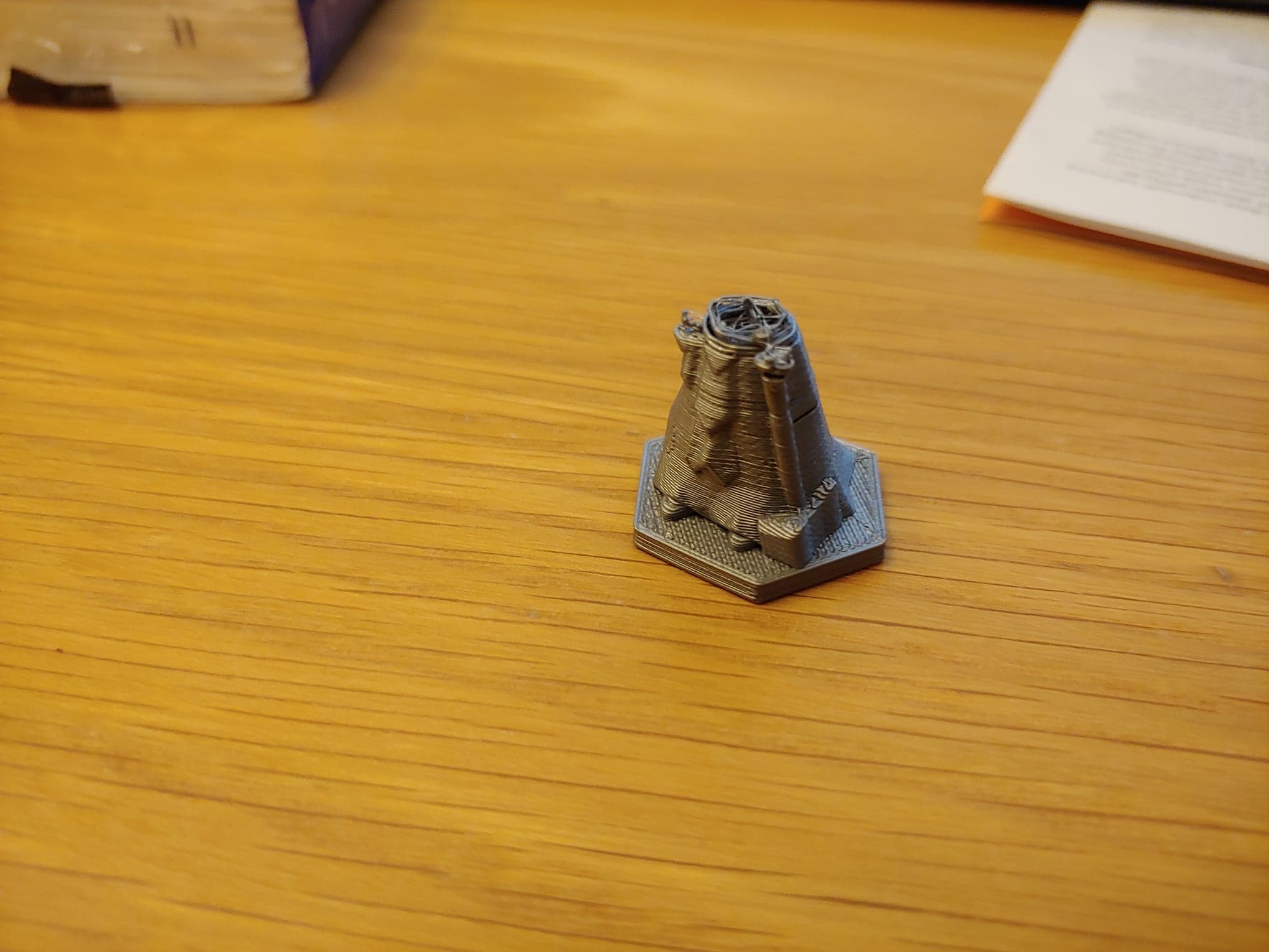

Some of the first pieces today was a knight figurine, 0.2 mm layers, first tested at 200C, this part at 205 C, failed both attempts when it had to print the hands, jumping to it between the body and the hands. Tried to save it by raising temp to 220C, which did seem to unclog it, but it was too late.

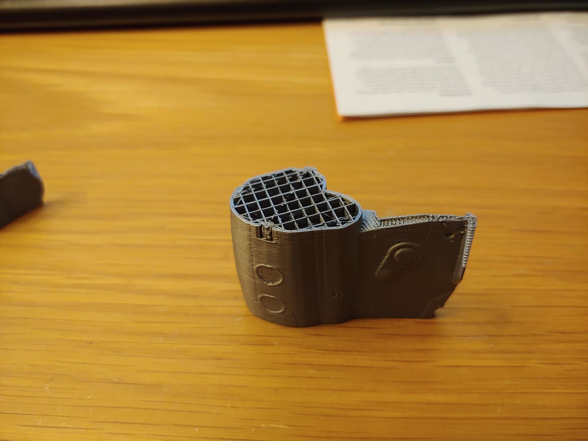

And it failed when it had to finish off the wing, clogging up, I tried to save it by manually raising the temp to 230 C in the software when I started hearing the extractor clicking, but it was too little too late. Sorry, already had cleaned up the mess of barely any extrusion due to the clogging when I took the pic.

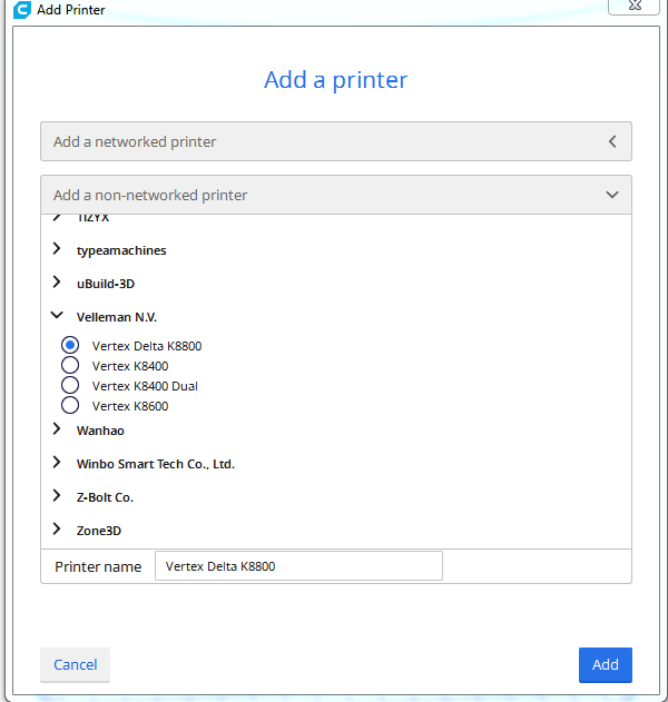

Did you select our printer from the profiles?

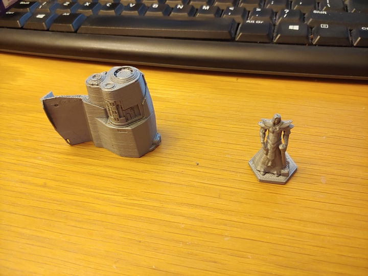

Happy times, default Cura profile manages to complete the builds.
The extractor still made the clicking noise after printing a (too) small section of the spaceship and moving on to the next section, so I guess it still has minor clogs, but ones that solve themselves with the bigger sections? Enough for the build not to fail. But I guess it actually is PLA.

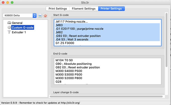

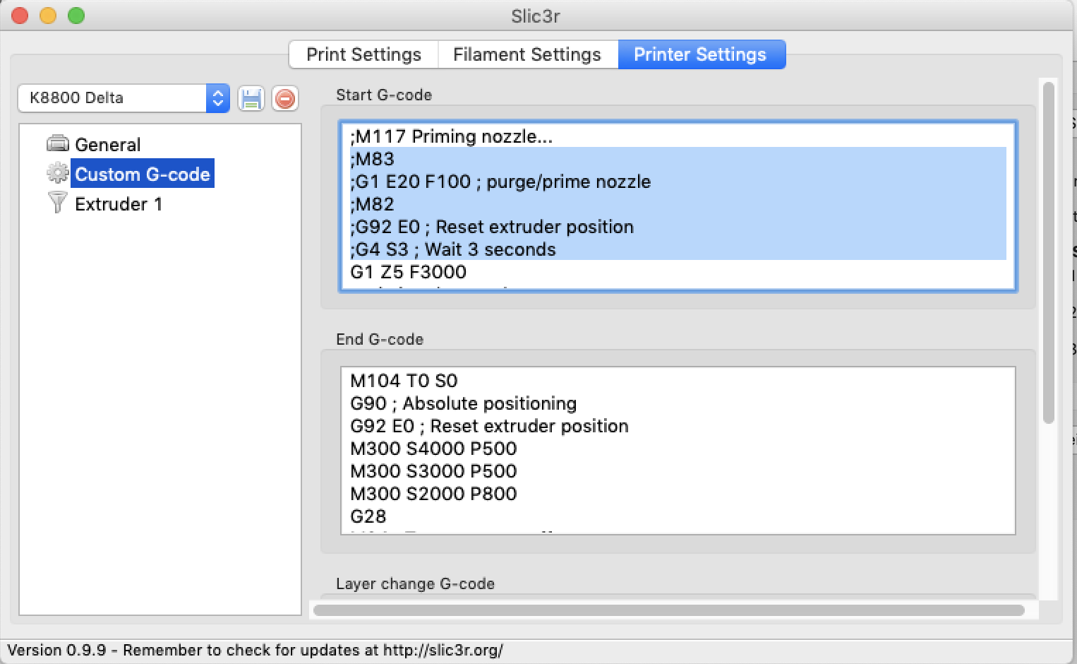

I got tired of having to babysit the printer at the start of each job, so I edited the startup GCODE to get rid of the nozzle priming step. No more blobs!
Be careful going with too high of an extruder temperature. You might be burning/cooking PLA into the nozzle.
How exactly did you edit GCODE?
In the printer configuration for Slic3r, you can edit the template GCODE that is inserted into each print job.

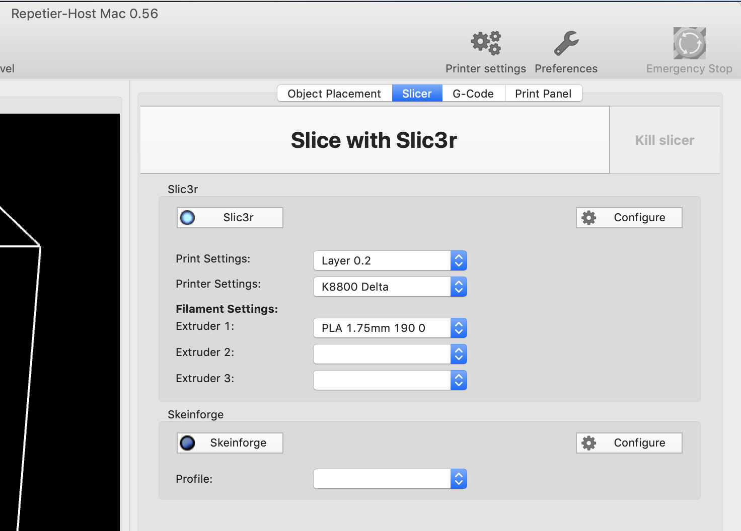

I am using Repetier Host on Mac. Open Repetier and select the Slic3r tab on the right-hand side of the view. Then click the “Configure” button in the upper-right corner of the tab.
This brings up the Slic3r configuration dialog box. Select the “Printer Settings” tab, and then select “Custom G-Code” in the list to the left. You can then edit the GCODE templates used by Slic3r. I added a semicolon at the start of the set of lines, highlighted in blue, to disable the nozzle priming commands in the startup GCODE.
Any models you subsequently slice will use these new templates.
