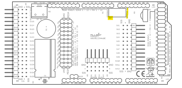

Please note: Make sure the IR RECEIVE/PROGRAM switch is set to IR RECEIVE.
WHAT DOES THE PROGRAM / IR RECEIVE SWITCH DO
The VRSSM SHIELD has a small switch, which let’s you choose between PROGRAM and IR RECEIVE. As the name implies, when you want to program the arduino when the VRSSM SHIELD is connected you will have to flip that switch to PROGRAM. If you do not do that the ARDUINO IDE will have trouble uploading your code. If you however want the robot to react to IR messages from the VR001 IR MODULE you will have to change the switch to IR RECEIVE (after you have loaded the correct code offcourse).
Slide the Switch SW1 (marked in yellow) to IR RECEIVE SIDE:
