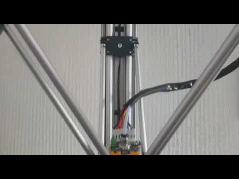

After the entire circus of calibration and loading filament I start the print. It calibrates again (sort of) and goes to the position in the back of the printer. But this machine also let’s go one of the rods when going to that position.
See video:

Hello again, I have been fiddling around with the machine today and I think I got it to work.
I undid all the screws at the bottom of the machine, well at least the screws that hold the rods where the magnet things slide up and down.
Now, the printhead doesnt ‘park’ outside the printbed and printing starts normally.
