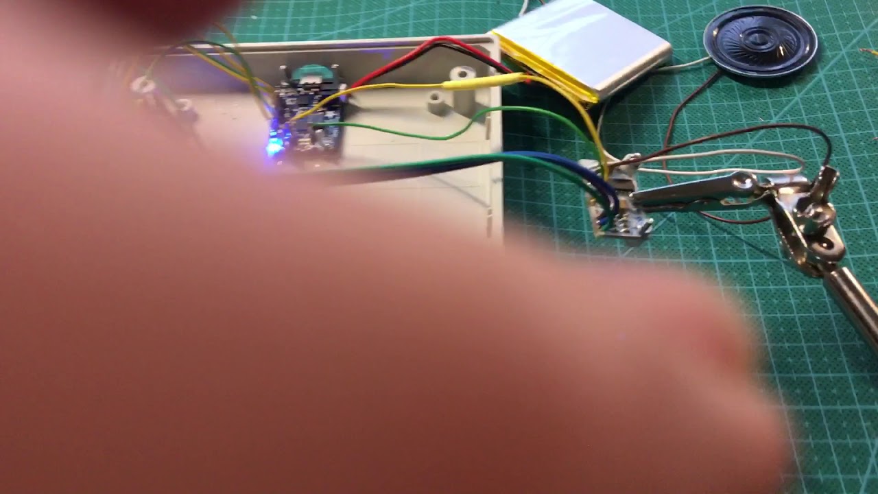

hope I’m in the right section. I’m trying to combine a VM202N MP3 Jukebox module with the VMA408 Super mini Digital Amplifier board for a Top Gun related project. I’m feeding both with an Adafruit Powerboost module and have measured I’m powering both successfully with 5 Volts of current.
I’m hearing 5 seconds of audio and then the volume fades away. The mp3 parts still seems to play, the light on the USB stick keeps flashing while reading, but I can’t hear any audio. I tried changing the MP3 file with the same results. 5 seconds audio and fade out to silence. Powering down everything and restarting gives me the same 5seconds than fade out. I haven’t used the pins for Switch/GND on the amplifier, not sure what to do with those.

Edit: A small video of the problem

Thanks for the suggestions, I’ll try to connect a portable MP3 player to the amplifier. I did try different mp3’s 128mbps, 192mpbs, constant bit rate, variable bit rate. Formatting the usb to fat16 and fat32. Another thing I noticed is that the SD card reader doesn’t work, only the USB connector.
I might take it back to the shop for that reason alone. I’ll report back with my findings.
As a follow up: I returned the MP3 kit to the sore I bought it from and got a new board, came home connected everything and… Success.
It was indeed a faulty VM202N MP3 Jukebox module. Thanks for the assist and advice.
