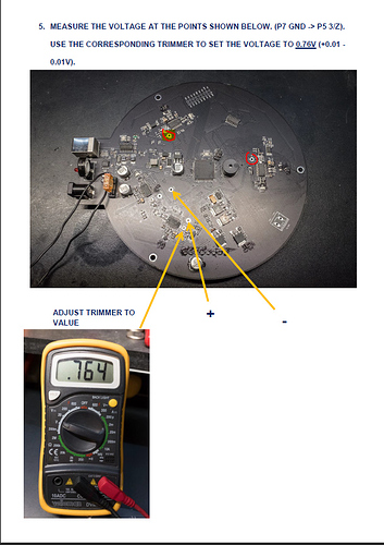

Check if the cable is correctly seated in the connector :slight_smile:

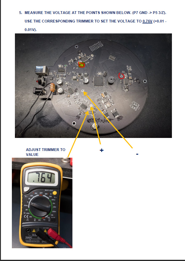

Also check the voltage on the mainboard
There are other test points
Sorry for late reply. I was away. I checked points you showed on the picture. The voltage is 0,76. It doesn’t help. I exchange the motor guessing, the motor is broken, but it didn’t help.
I have no more ideas what is broken. Is it possible to exchange motherboard? I think at this moment it is the only one solution.

Yes this seems like a faulty motherboard…
