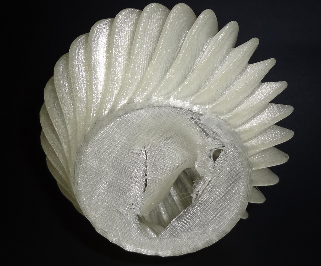

Another test:
Hollow cylinder, spiral vase, 0.4mm walls, 0.2mm layers, Slic3r
The artefacts on the right and left are due to the pulleys, clearly visible now.
Before the leadscrew upgrade they weren’t noticable though :wink:

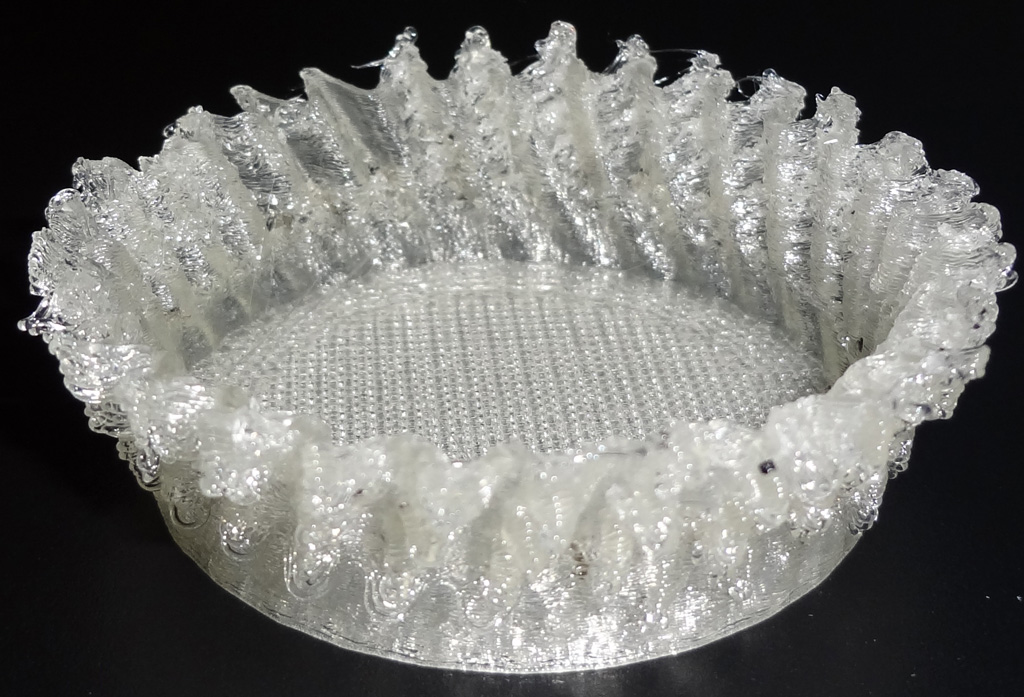

I received my Z rod (K8204) yesterday. I’ve mounted it as in the instructions, but made sure that the rod rests on the motor axle and the weight is not on the flex coupler.
For that I placed a steel ball from a defective ball bearing on the motor axle and lowered the rod onto that ball.
After that I tried to print the same vase as you (ichbinsnur) did using Cura (as usual):
Cura made a complete mess of it (or rather, I made a complete mess with the settings!).

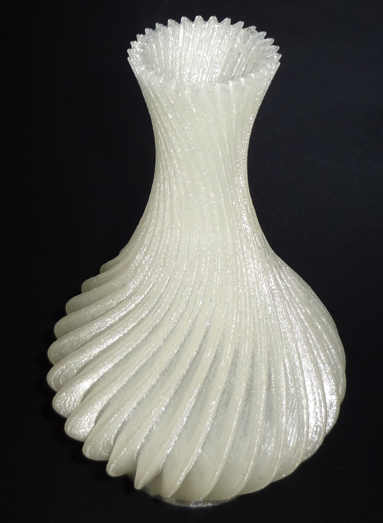

However, I tried it again with Simplify3D and the result is excellant:
Unfortunately I couldn’t remove the vase from the BuildTak sheet without braking it.
PLA sticks like hell on the BuildTak sheet:
I had to heat the bed to 80° to get a sharp knife under the vase.
60° would probably have been better :slight_smile:

Quite nice print though!
Did you use the Velleman hotend?
Cura engine is known to have problems with slicing spiral vase things.
I had to fiddle a bit and found out it only works if the outer perimeter is not wider than the nozzle diameter
and the wall thickness is set to nozzle diameter in the cura settings.
Slic3r seems do to a better job on such objects.
Yes, the print looks really good (in fact much better than on the photo).
I use a E3D hotend (v5 I think) with the standard 0.4mm nozzle.
Layer hight was 0.21mm for the vase.
I didn’t feel like fiddeling about with the Cura settings, so I just switched to Simplify3D, allthough Cura is my prefered slicer and I print approx. 90% with Cura without any issues.
But thanks for the info, I might try it next time with Cura.

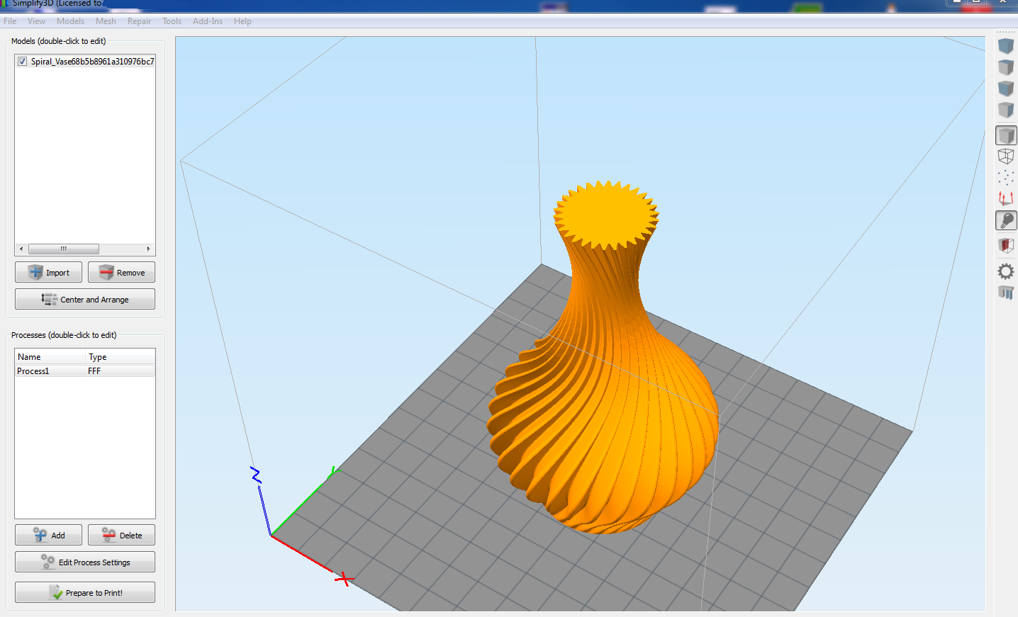

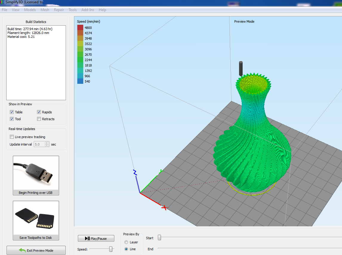

Hi Chris
Just to give you an impression of Simplify3D:
It’s really worth a try!
Regards
/R
