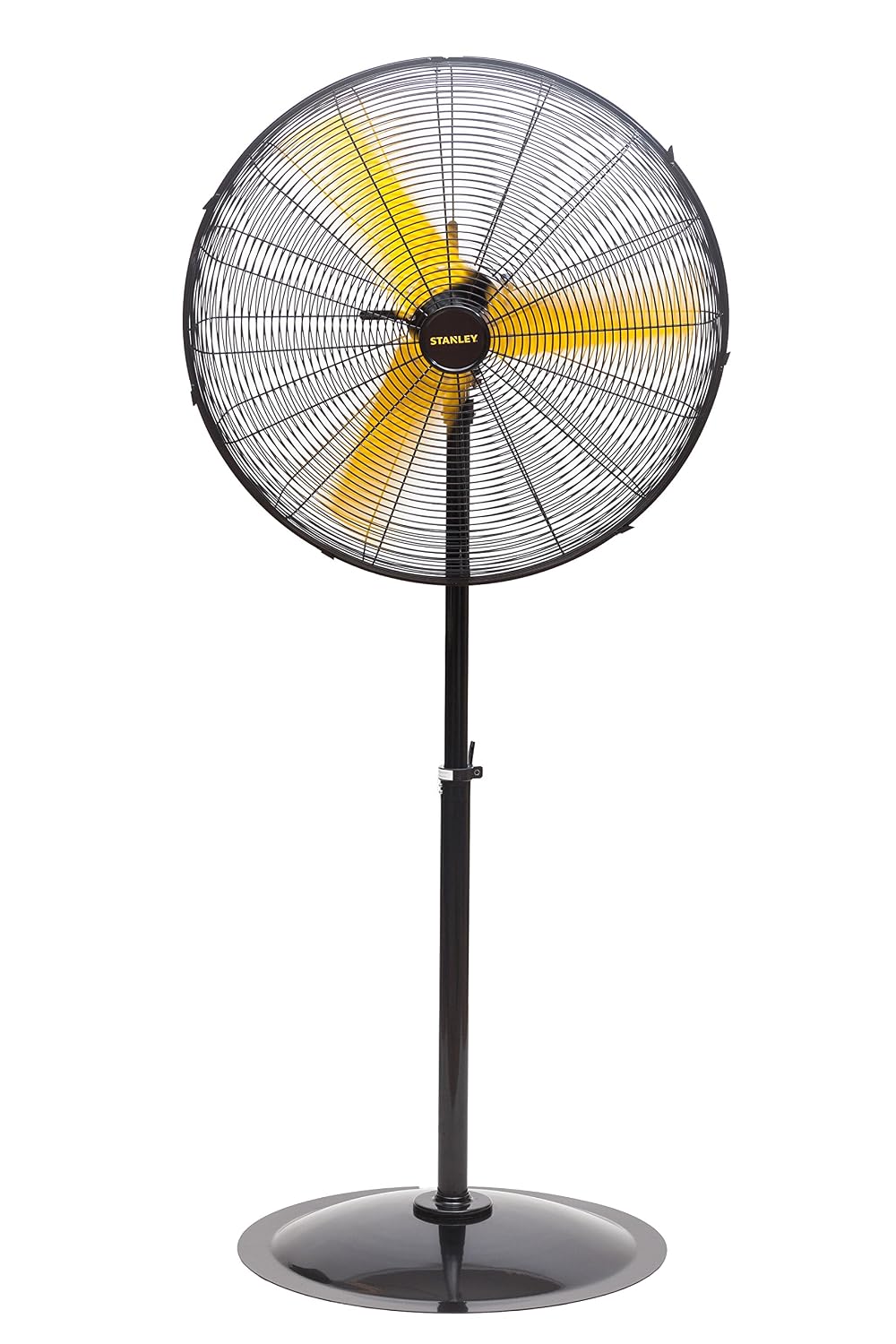

I would like to lower the speed even more of my current Stanley ST-30P-DDF-E fan, which has already 3 speeds. But even low (speed 1) is too fast:
Data sheet (other brand, but very very similar), see model: MAC-30P-DDF-B:
masterindustrialproducts.com/wp- … M_2015.pdf
So, I though function 13 on this K8028 kit would be the best option to change the fan speed (better then using potentiometer, since its a synchronous electric motor, with no brushes). Then put the actual fan in speed 1 and then use your kit to further slow down the fan speed…
