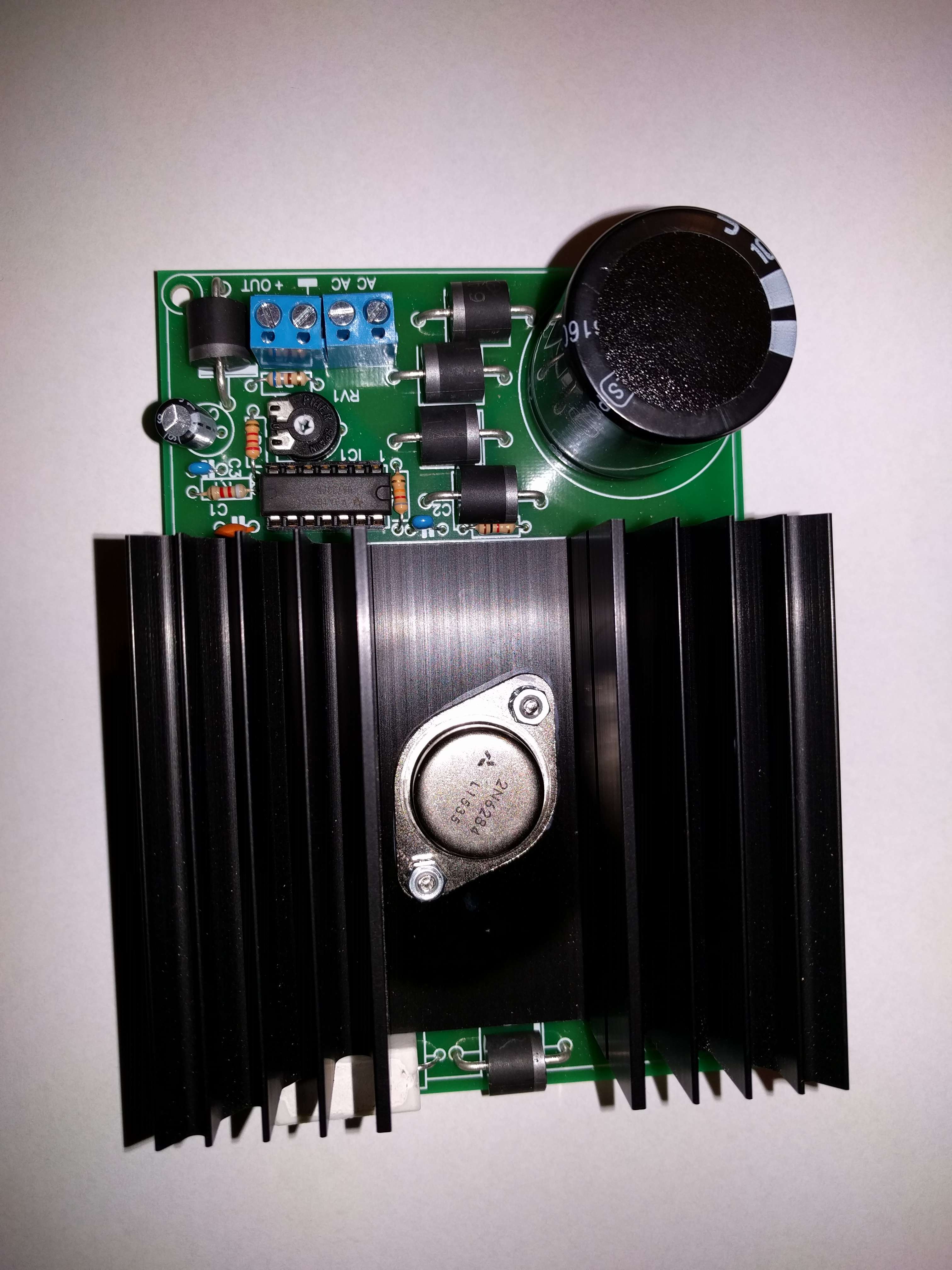

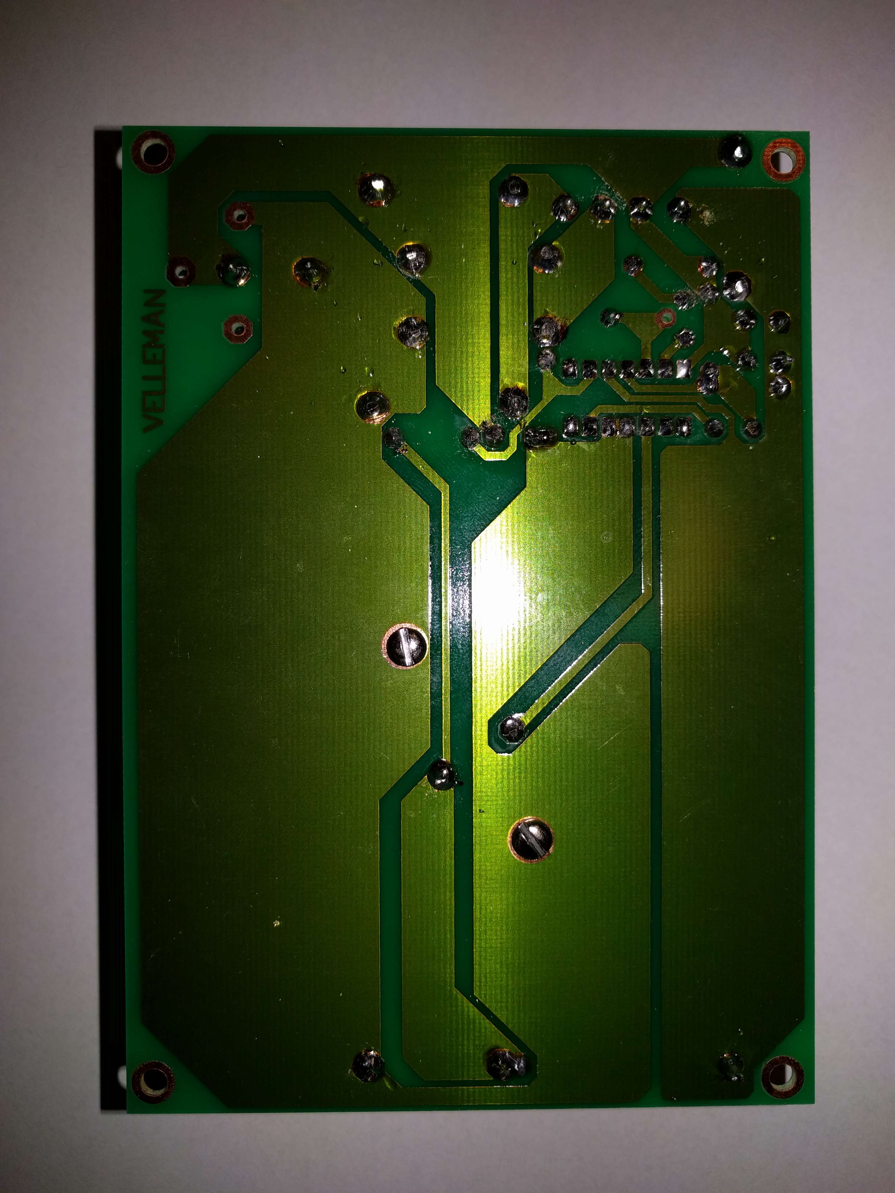

I have build the power supply kit K7203 with the suggested Velleman transformer 5015.
After building and checking the solder I connected it to the mains and the fuse blows.
I rechecked everything for shorts, bad soldering and/or bad wiring but still the fuse blows.
I am stuck!
It is still under warranty, would sending it to Velleman be a solution?
Here 2 pictures to show my handywork:
Could you post clear pictures of the top and bottom of the board?
Maybe someone will see something.
Thank you for your reply, I edited my post and hope the pictures are clear enough
