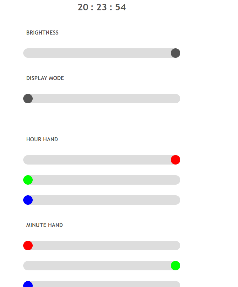

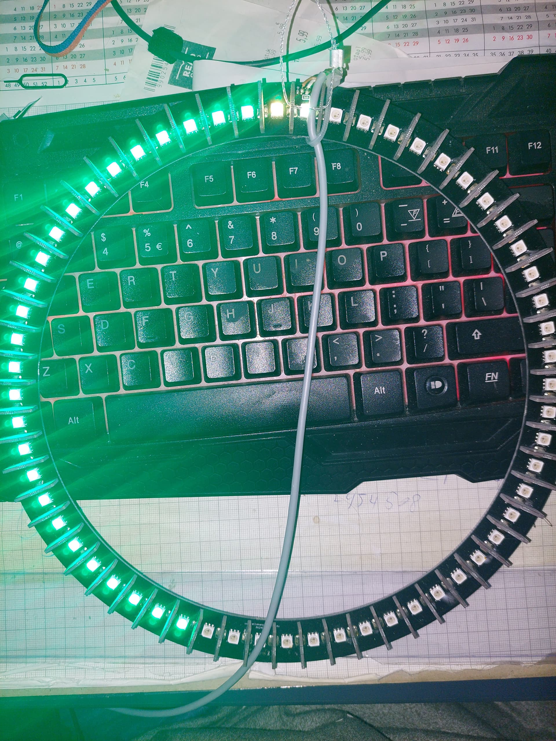

Currently when I’m connected I indeed get the green circle but it isnt compleeting when I look in the serial logger I see this (IP’s striped away).
but I can also see it in my network but I wont respond first I also had that it stuk on the setDualAntennaConfig but now not anymore the time is showing correctly in the discover tool and on the web.
But the clock shows this:
(my cable connection is on the top) How to get out of this state?
The responses in the app are registerd because when I edited the GMT offset the time changed…
