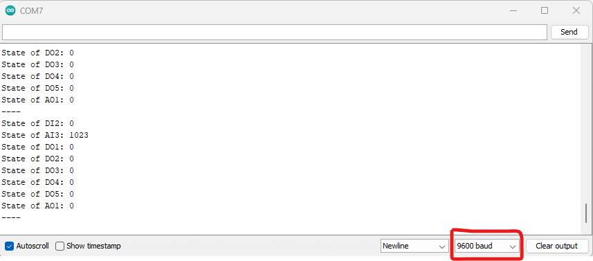

Hello,
I have resolved my first issue, TxD and RxD connection has been swaped, now I can see in COM port output some correct data :slight_smile:

Hello @Alexander.Gach
For Serial monitor connenction make sure that the baud rate is set onto 9600. look in sketch for:
void setup()
  //start serial for debugging
  Serial.begin(9600);
