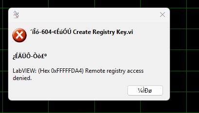

I get a registry problem trying to run the software.
And reading the logger does not work,.
I have made sure that I have .NET 3.5 installed and enabled but it does not help.
