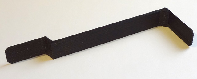

I will wait to buy the printer until they solved the heatbed. I understand that abs will stick to the buildtak service, but abs will definitely crack between layers when printed on a cold bed. PLA has a much stronger bonding to its previous layer and does not shrink as much as ABS. After printing many ABS parts on my reprap i2 I learned that the only way is a steady temperature throughout the whole part, using a heated bed and insulated build chamber.
This printer is not capable for ABS because of lacking the heat bed and enclosed build chamber.
