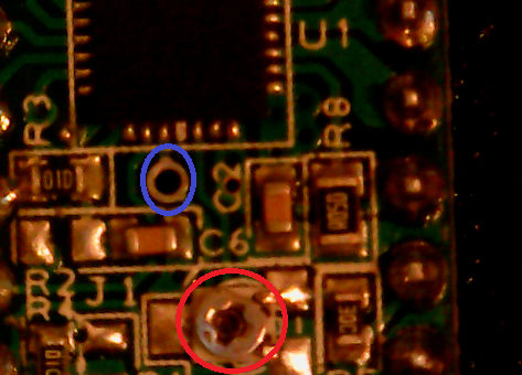

on your driver there is a screw that you have to turn (i highlighted it on the photo with the red circle)
you can measure the output voltage with the test point (highlighted with the blue circle on the photo)
just put your positive probe on the test point and your ground on the ground of the k8200 power supply.
it is advised to use a plastic screwdriver.
Exactly what I needed thank you very much!
