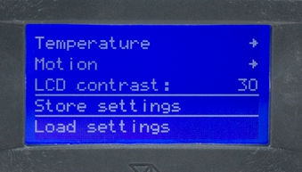

After you did the first calibration did you save it?
Yes but i did the test right afterwards so without switching OffOn it should remember the calib
I guess what I am asking is did you Store the settings from this screen
3127

Yes i used this option
