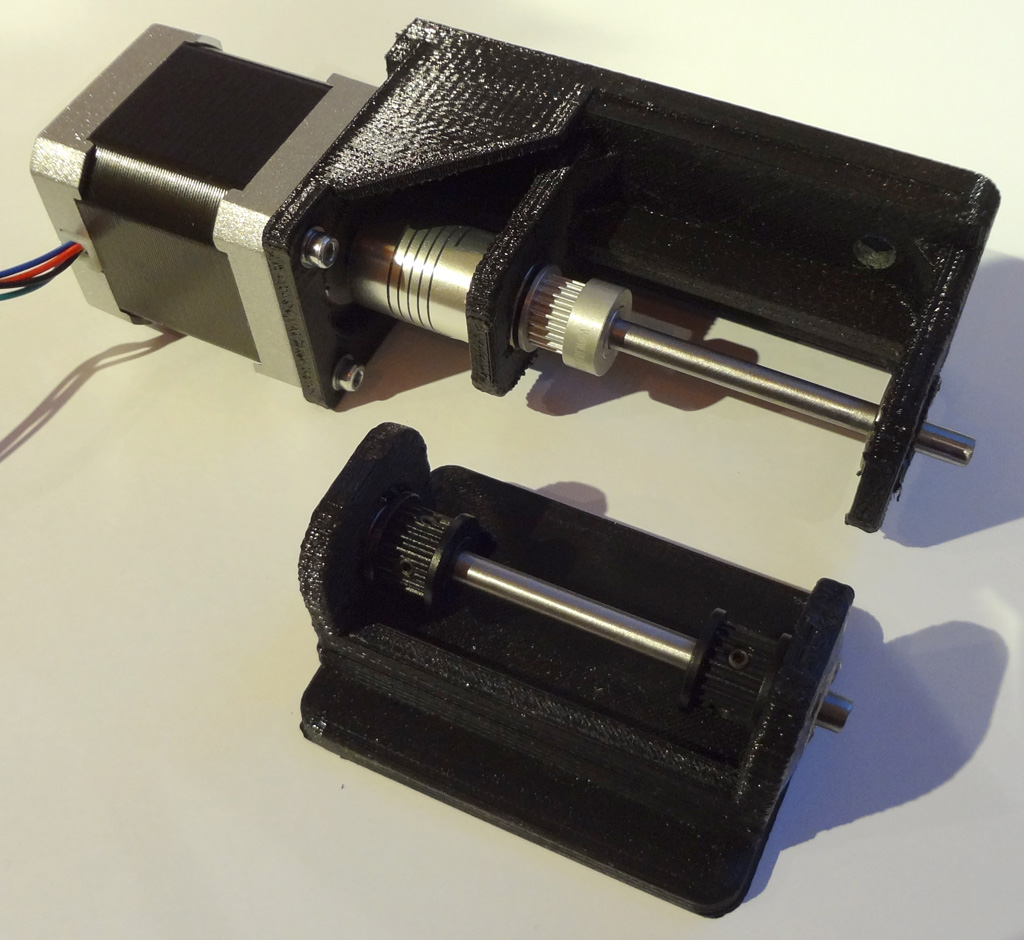

However, I ended up creating a new mount for the X axis motor driving two GT2 belts.
This is what it looks like:
The new motor mount with a flex coupler and the left-hand side pulley mount.
Both parts incorporate two ball bearings.

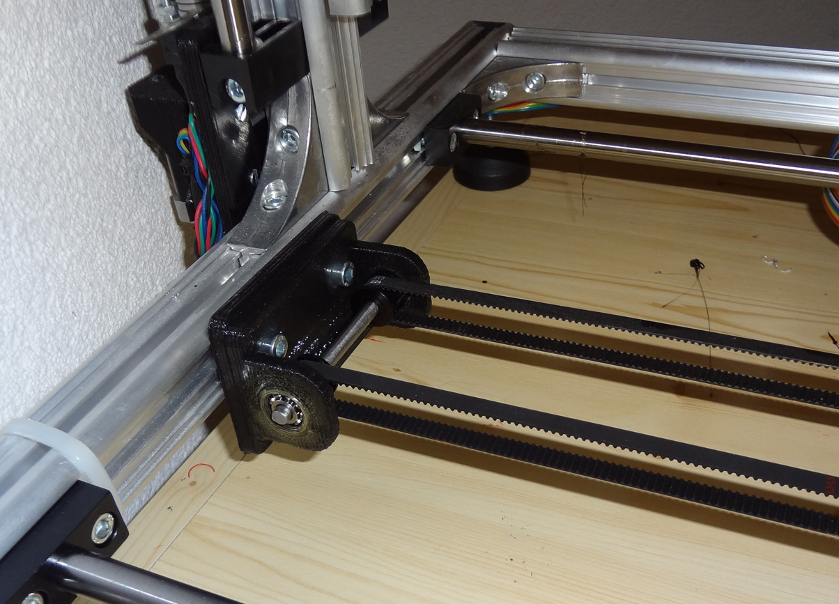

The belts are almosts centred on the X axis.

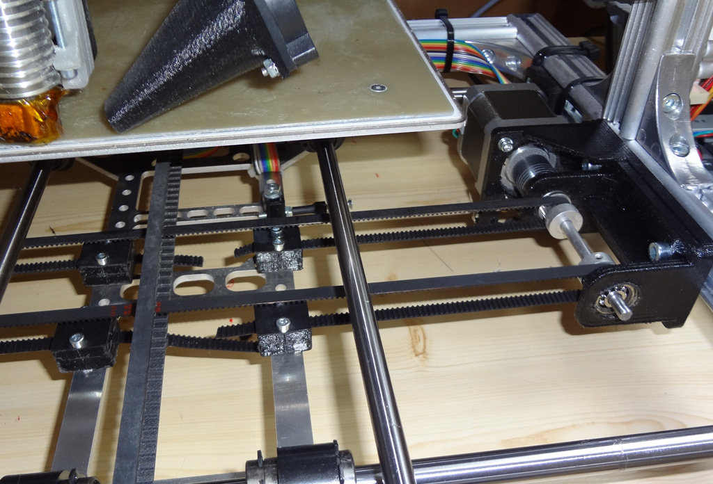

New parts were created to fix an tension the belts and also to get the top and bottom belt parallel.
I haven’t yet done many tests, but the vibrating is gone completely.
The surface of the printed object is better than before. Especially the waves towards the end of the object are significantly less.
