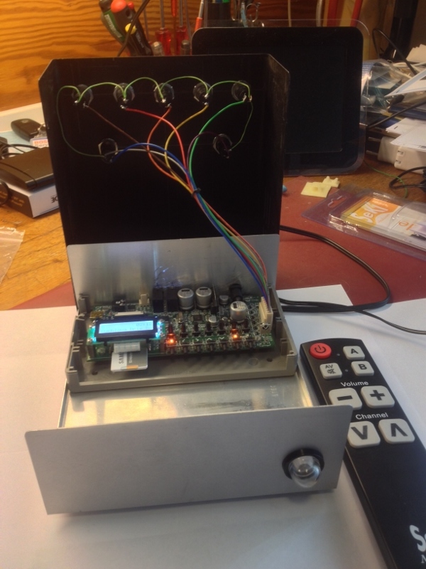

Hello,
My VM8095 module crashes after certain time, is replaced by the seller but also the new one has the same problem.
After switching the power supply off and on again, it works for a time, but it will crashes again.
Using Velleman’s standard programming and I have 5 push buttons placed externally and use a Velleman VM191 remote control.
Temporarily I use a timer and regularly switch off the mains voltage and on, then there is no problem.
Can someone help me?
Tnx for reading, best regards,
John.

Hello VEL255,
I am using the standard wires delivered with the module.
And yes, the module also crashes with no external push buttons and there wires connected.
I am using extern a 12 volt dc 1,5 amp powersupply.
The module is mounted in a box.
I will look of i can send a photo of it.
That’s a very nice setup.
But I wonder since you have it in an enclosure is the unit over heating?
It does not look like you have any ventilation.
Maybe you should mount a small fan.
How long can you run it with the cover open?
Have you tried a different power supply maybe it has an issue.

Hello.
The temperature in the cabinet was 30 degrees Celsius and the temperature of the components were also the same.
The powersupply was 12.2 volt en the load was minimal, because the amplifier is not used only line out.
What I have found is that the line-out and speaker connectors were connected to the cabinet.
This was not my intention given the plastic frame that I used to mount the module.
I have resolved this and am now waiting for the next crash or a possible solution via this site or from the support team of Velleman.
Thank you for reading.
John.
