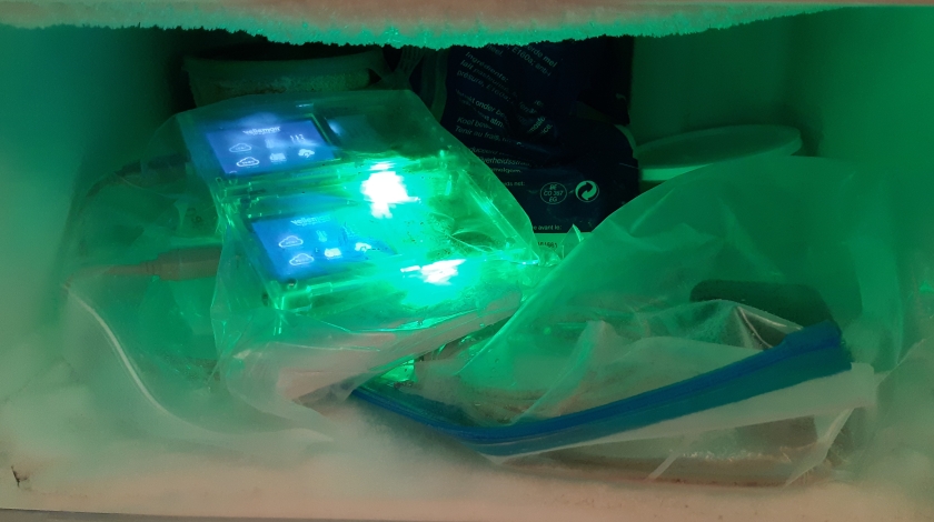

Hi @Firebird88,
We have tested the VMA342 AIR QUALITY SENSOR COMBO BOARD with various temperature sensors and humidity sensors in different environmental situations to calibrate them. We have seen a small offset for both values, they are manually fixed in the code.
The temperature is lowered with 3.3 degrees, the humidity is increased with 17 %. These values were calculated from our experiments, but can be modified in the code if your own findings are different from ours.
You can read this in our manual @ 4. All about values under chapter 3 “Compensation”.
And just to show you, we even tested this offset in crazy situations (see attached picture).
