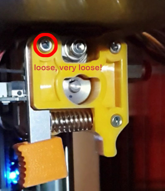

The filament problem, I’m not really sure, seems to cause with the extruder. I observed, that the extruder jumps sometimes back, making this “klack”-noise. I marked it with a blue dot, as you can see in the picture.
Sometimes the extruder acts in a row like this and while doing this the filament goes backward (you can feel it, holding it loose between your fingers) therefore not enough filament is put on the plate. Do you think this could be the reason for this problem? If Yes, any idea how to solve? And yes, the one screw is everything but NOT tighten!

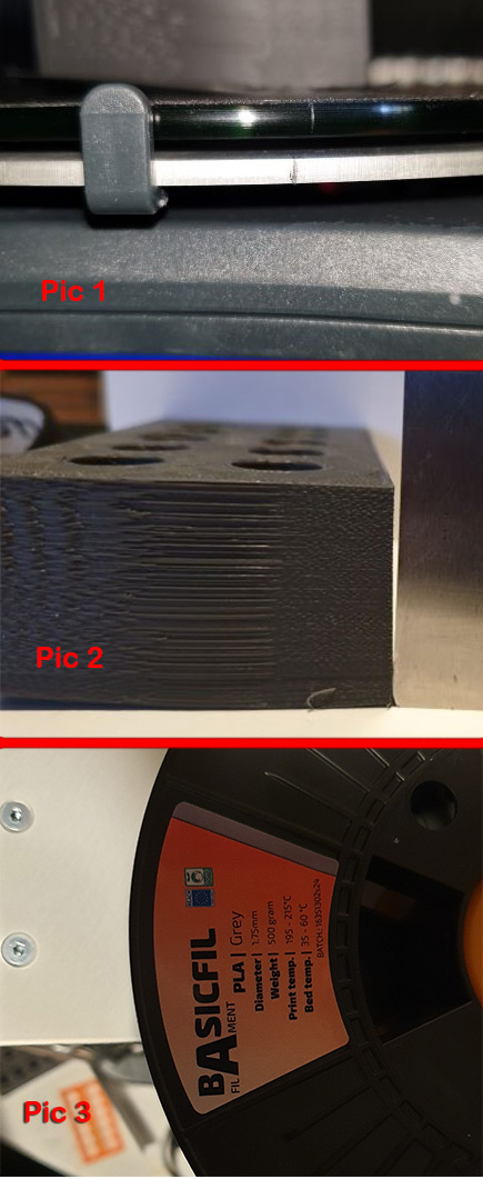

Cleaned the underside of the bed and the sensors pad. As you will see on Pic 1 it’s still ‘moving’.
And the result (printed with the standard configuration 0.2mm) you see in Pic 2.
The object is 35mm in hight.
Sure is the print configured for the right material. 1.75mm PLA (See Pic 3). I’m not quite sure what you mean with a good flow. But the ‘Let’s jump back a little’ phenomen happens during the print also. But not so often compared with starting the print or loading the filament. I’m trying now the third filament. Sorry, but can’t tell you the brand of the two others (lent them from a friend).

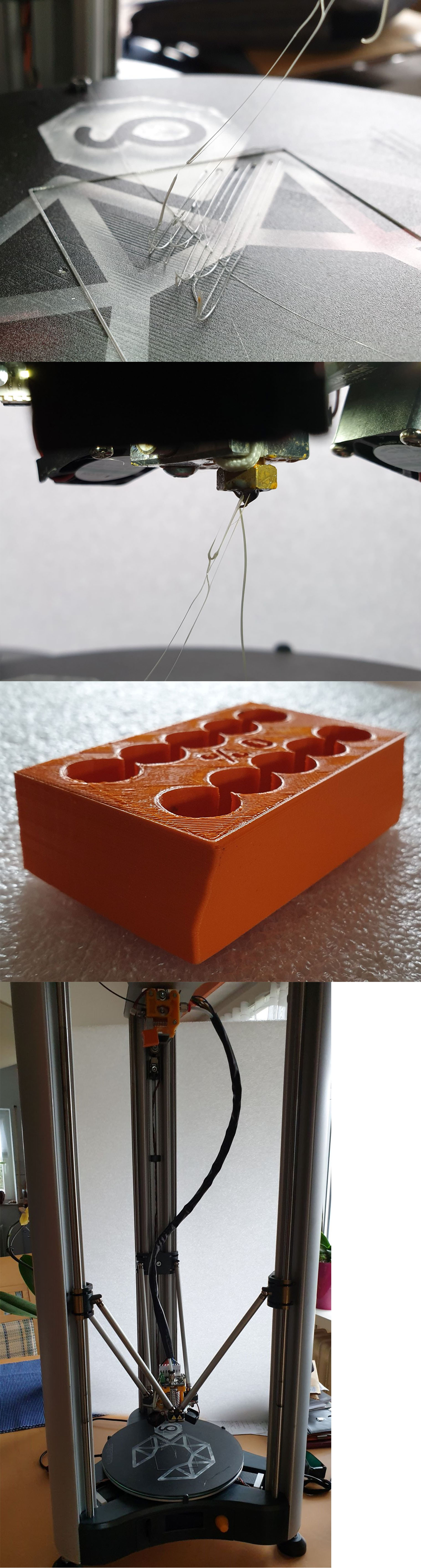

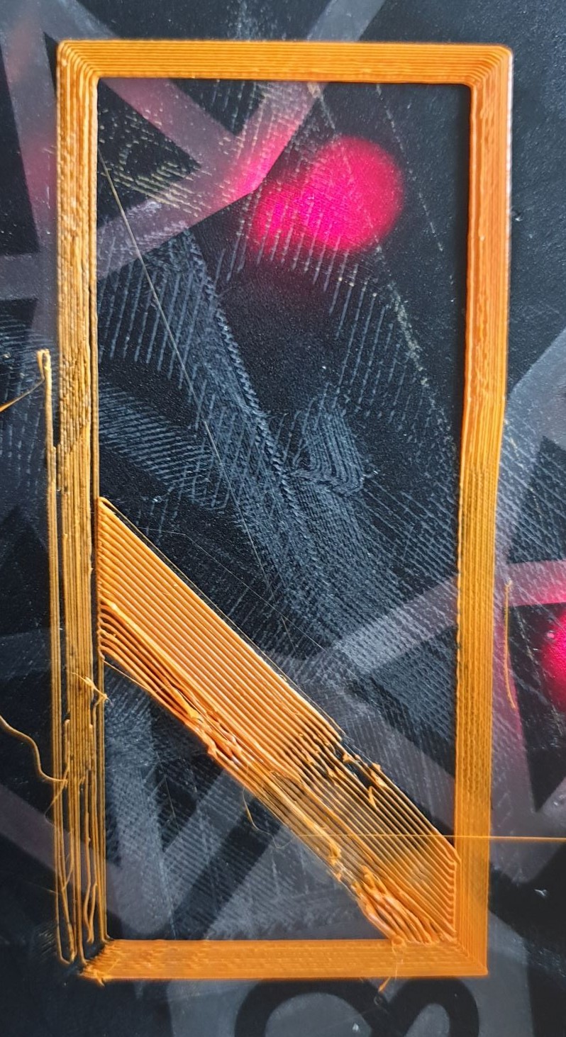

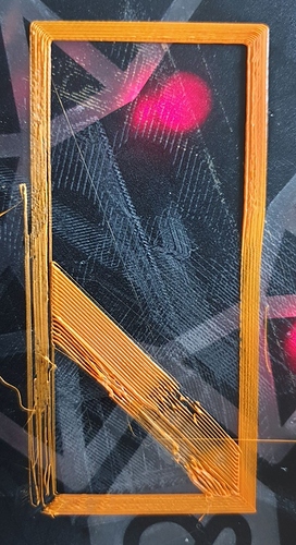

This is how the first layer looks!
A friend of mine assistet me and with his experience we tried to check every possible error sources, other than “It’s not calibrated”.
- The filament extruder problem seems to be as old as methusalem. Got never a answer regarding to this problem (except from VELL337 “The skipping is also not normal behaviour” - Really?). The user Maddin wrote in Oct. '18 “Filament feeder keeps jumping back” Disgusting is the answer from VEL327 “This was a problem with some of the printers of the very first batch production run. It could be you have one of these printers.”. The problem is at least two years old and I bought my Delta in Dec.'19. Must have been forgotten somewhere in the cellar and suddenly someone found it again?
- While watching during printing we recognized, that the printer head is not really moving in a straight line. Exploring and searching for the reason we saw that some of the rods are slightly bent out of shape. Makes every attempt calibrating the printer useless!
- As written in the Problem solution PDF file, we tried to adjust the piezo sensors. Both of us had been very impressed how the potientometer ignored everything. We couldn’t notice any change! Guess the potientometer is a dummy or broken.
