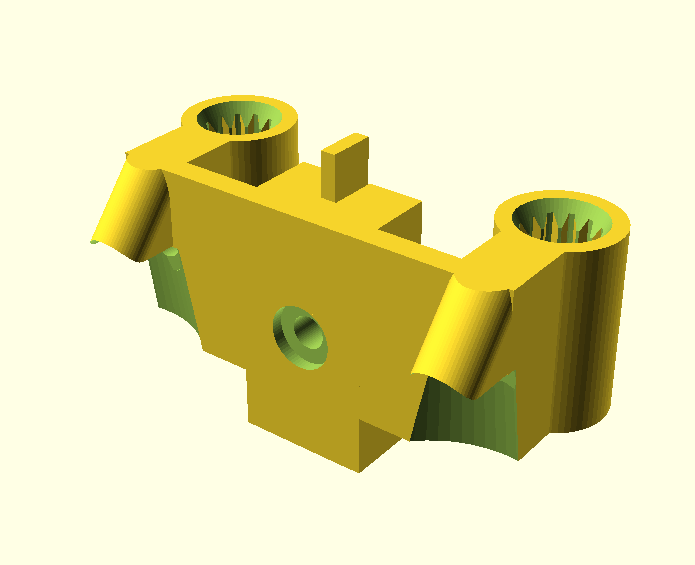

I threw together a design with incorporated, printable bushings. I have not tried this out yet, nor even printed it, but I’ll share it in case some brave soul wants to try it out.
I think these would need some light lubrication, maybe a bit of mineral oil.
UPDATE: This part is a WIP and has a couple known flaws:
1.) The clearance on the bushings is too small, so they will need to be enlarged with a drill.
2.) The slots for the captive nuts is the wrong internal shape, giving them too much wiggle room.
3.) The front lower corners of the carriage are a bit thin, and so the structure is not as rigid as it could be.

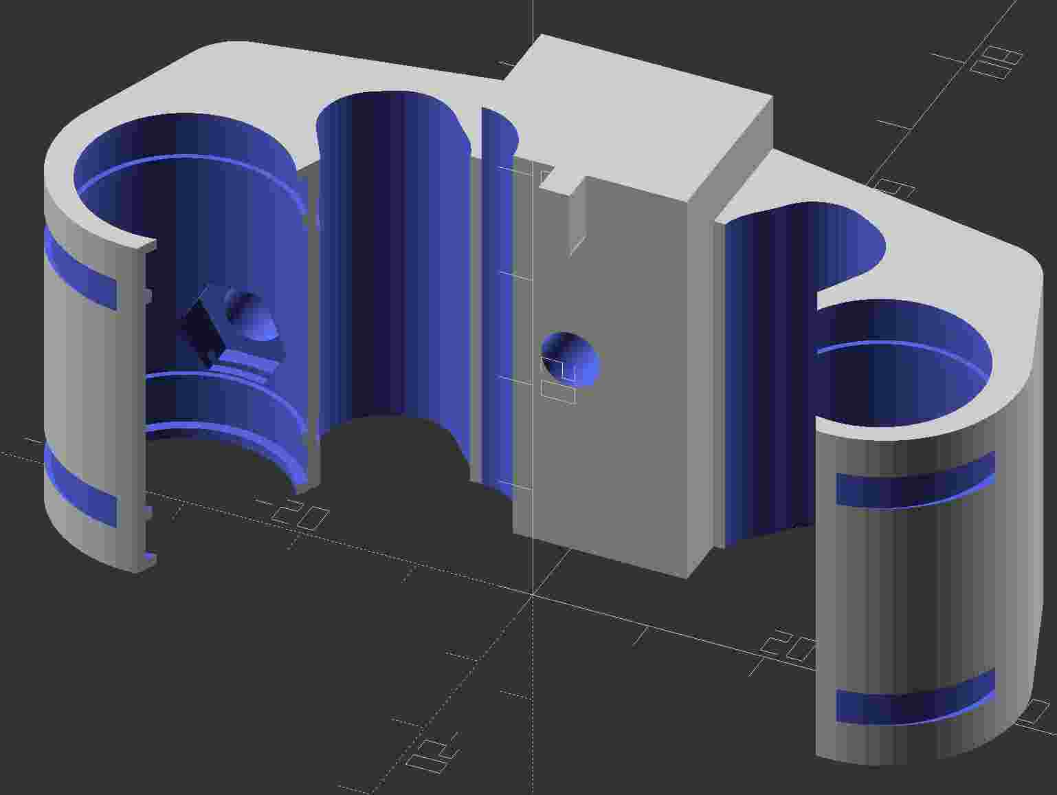

Just tried to get in my ideas to the VS (carriage) from @Dr_Vegetable.
Changes:
  • endstop plugged in from top of carriage, so no need to disassemble/assemble the whole printer when trying to play with endstop
  • tried to add “simply plug” feature for LM10UU, RJ4JP and RJUM1 bearings, Simply selectable via “bearing_type=x” in .scad source
  • added top/bottom brim and notches to plug-in the bearing into VS
  • small (trials) to optimize the model
  • three different endstop actuators (5,10,15mm)
  • Proposed resolution: 0.1mm layer height
.stl and .scad available from github

@SusisStrolch there is a lot to find in your repository! :+1: Are you still optimizing or is there a final version of the vertical sled for RJ4JP bushings with or without zip ties to find?
The repo holds my latest iteration of vertical slider.
Unfortunatelly I didn’t find the time during WE to print it.
I found some issues with the previous iteration
  • you MUST use zip-ties, otherwise the print head is too spongy
  • the nut hole catch was too tight
  • the bold hole through was too short, so the bold pressed against the bearing

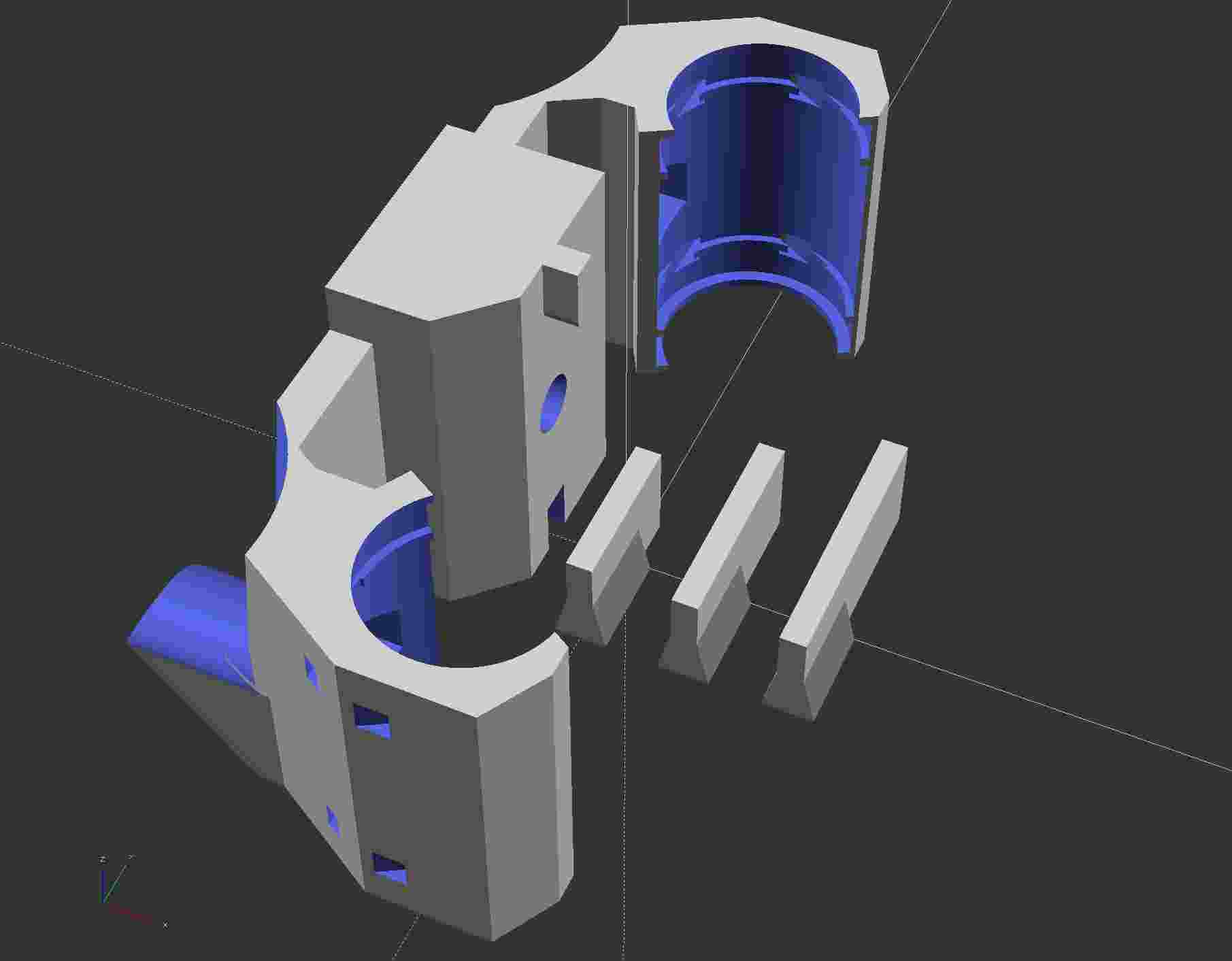

I’ll will upload two additional test files - a single bearing holder and an reduced belt catch block incl. the endstop, so you can check the overextrusion and the sizes w/o having to wait 3hrs.
Did an update of the repo and removed unused files.
Print / assemble instructions:
layer height: 0,175 (= 1/2 nozzle dia)
initial layer: 0,245
wall thickness: 1,05 (= 3* nozzle dia)
top/bottom thickness: 0,7
build plate: brim
brim width: 6mm
brim only on outside
infill: 50%
pattern: gyroid
no support
no alternate skin rotation
no adaptive layers
You’ll need 3 bolts M3x12 (M3x15) for endstop adjustment.
No need to tap the threads
The endstop actuator should sit pretty tight in the belt catch block.
The zip-tie slot is too tight - I’ll rework it

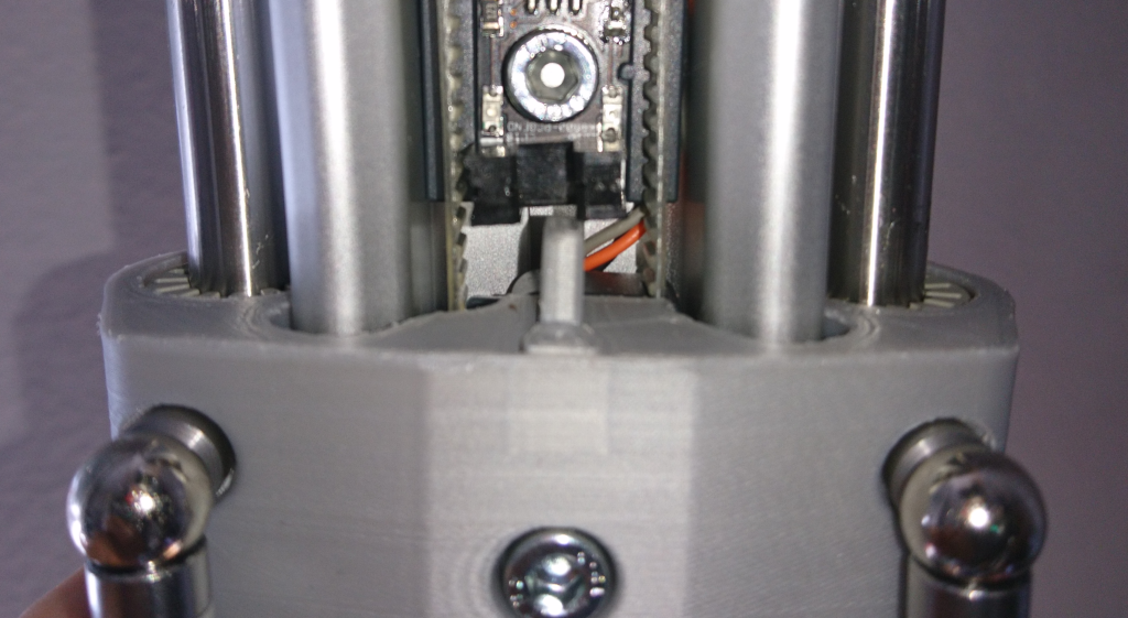

I also think that the actuator is to thick it scratches at the optocoupler of one of my endstops when homing. (sorry haven’t tried your latest upload yet sorry)

I have not had a problem with the width of the endstop actuators on my original design. In any case, the tab should only need to be thick enough to interrupt the light, so 3mm is probably overkill. I don’t know how the width compares to the ones designed by SusisStrolch, however.
mine is exactly 3.5 as well. So I had a closer look and the collision is a combination of sled tilt and actuator tilt in the same direction. May be it is clearer on the photo:
