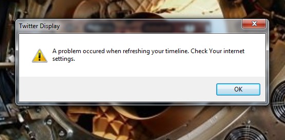

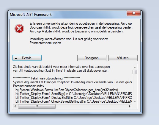

The first one is that the twitter app don’t work. He gives the message that there is a problem with the internet connection. When I click at ok the follow message I get to see: and
I haven’t any problem with my internet connection.

Are you connected to the internet via a proxy server? What version of the windows OS do you have installed? Do you know what version of the .NET framework you have installed?

Hello Vel327,
I’m not connected via a proxy server.
The version of the windows OS wich I have installed is Windows 7 Ultimate SP1.
The version of the .NET framework which I have installed is ‘version 4.5’
I haven’t any coding background. Is it easy to learn?
Your computer meets the requirements to use the kit. Did you test any of the other supplied programs? Do they also give an error or is it only the twitterfeed application?
VB is rather easy to learn. Also with the supplied .dll file the hardest part has been taken care of. You will not have to write any code to communicate with the kit. You just supply the data that needs to be displayed. You can test all of the functions you will have access to with the supplied test program.
I did test any of the other supplied programs and they work.
Only the twitterfeed give this error.
Is there made a mistake in the twitterfeed?
