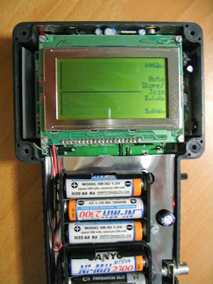

Below is my K7105 before and after
Deteriorated LCD screen. Able to power on but center portion unreadable

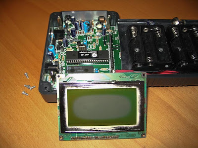

LCD removed to be shipped back to Velleman

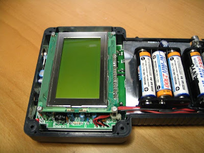

Replacement LCD fitted when it arrived a week later

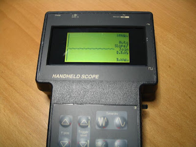

Power on test. Perfect!!!
Reassembled Kit ready to second life
