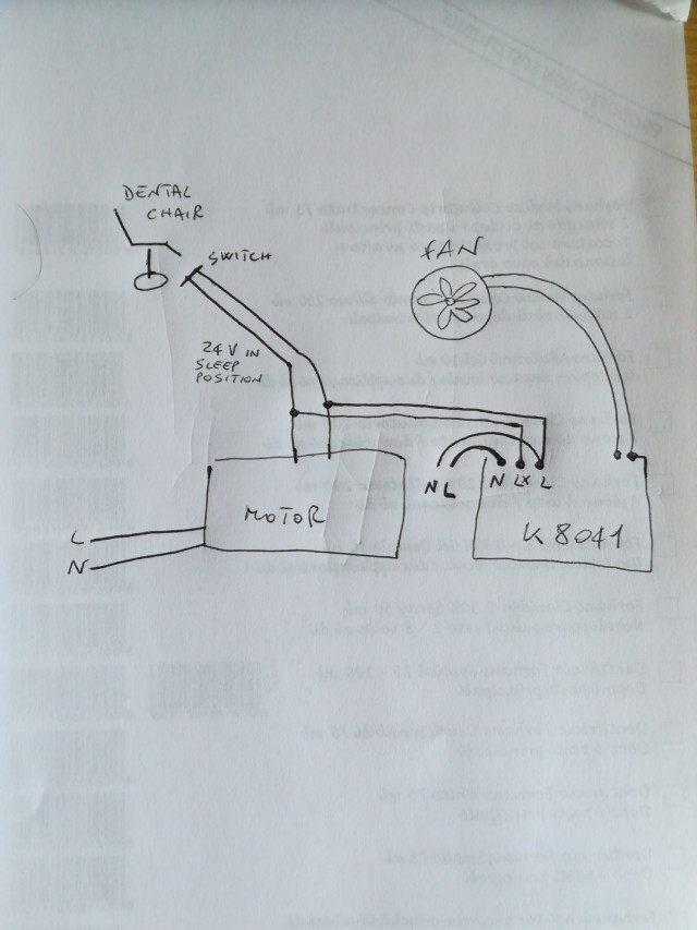

I would to cool the motor when it is on and some minute after stop. The switch that turn on motor has 24v in sleep position and 0v in on position i can use the same switch or i have to put a new switch only for relay?
15621412085676450698057103052484
Like this

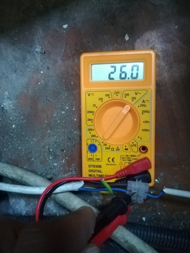

Is that 24VDC or AC ?
A/c, it came from motor board, when i close the switch is 0v
IMG-20190703-102740

It isn’t the 24v to power the relay… Just the contact instead to be a simple smooth switch inside there is 24v it is a problem this tension inside the circuit? See the scheme
